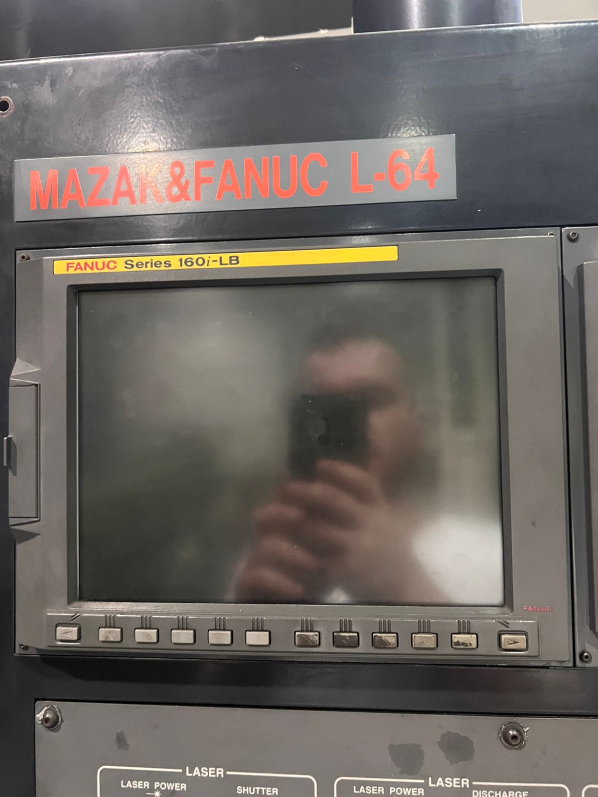

11 Aug 2025 18:40 #333241
Replied by tommylight on topic HUGE Mazak fully automated 5 axis laser cutter for pipes/tubes/profiles/
@ErrickW
Here is the exact controller model/type.
Thank you.
Now they have another issue that i think it is a safety feature, not an issue:
- when the left side is a straight cut, unloading works properly
- when there is any angle on the left side, even 4 degree tested, it will not unload, the left most spindle will not move at all
That is all the info i have so far, advised them to do a test cut where the angle is on the right side with the left side left straight, i have a feeling it will unload, but waiting till tomorrow for the result.
Thank you.

27 Aug 2025 10:38 #333984
Thank you Erick, i just talked to them and everything is OK, the left side angled not unloading is a safety feature as i thought, so the idea of leaving a straight cut in front of it with small tabs worked like a charm.
And we do have a pallet of manuals, mostly in Italian language and mostly not exactly for this machine as the pictures show the old version of the software, but still they did help a lot initially.
Again, thank you very much, i do appreciate the offer.
