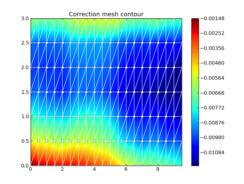

I also had to install python-matplotlib. (first error I was getting for stlvis.py)
Now I am trying to get stlvis.py working
Here is where I am
I am probably just missing a whole bunch of dependencies/librarys but I didn't see any prerequisites on the probekins page.
Here is where I am
alan@alan-cnc:~/Desktop/probekins$ ./probe2stl.py <probe.txt | ./stlvis.py -b 0,0,254,254
File "./stlvis.py", line 47, in <module>
main()
File "./stlvis.py", line 40, in main
pp.tricontourf(x,y, z,256)
AttributeError: 'module' object has no attribute 'tricontourf'

stlvis is now working with:
alan@alan-cnc:~/Desktop/probekins$ ./stlvis.py -b 0,0,9.5,3 probe.stl
