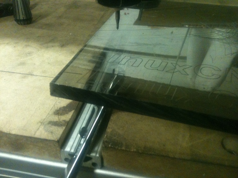

So I have it working and it seems that if the gcode command doesn't have a Z move then it doesn't adjust the depth. It only adjusts on the initial plunge.
I'm guessing the simple fix is to make sure that all the gcode commands have a Z move?

That's unexpected. The kinematics module calculates z every time, regardless of whether it has changed.
What is the probekins "enable" pin connected to?

Keep in mind that the offset is behind the scenes, and the Z dro wont show the offset that is applied.
It should show up in the pyvcp deltaz display when it is enabled. Does it behave as expected with jogs?

So I based the depth test on a warped PCB surface and with probekins turned off it didn't touch the surface at all. The cut is a small circle. With it turned on, the small circle was cut but there is a long cut across the pcb and it starts on the low side and goes through a high spot. probekins did not adjust for it. I could tell just by the cut depth as it moved across the surface.
as for the jogging, there is that weird behaviour that you described when in joint mode. But when I switch to world mode it jogs fine except for touchprobe doesn't work.

What do you have the increment set for probing?
for a pcb, I'd do 10 per inch maybe? See if that helps compensate better.
Or does it not adjust at all?
Also make sure when you do the probing there are no x or y offsets applied.
Then when it finishes with the probing, enable the Z correction before doing anything else.
Then set your offsets for the job.

ok, so I'm missing something. I first ran the probing before setting up all the prokins configs. But now when I run it with prokins loaded it says that I will exceeed the min joint limit. So these are my steps:
1. launch linuxcnc with prokins
2. Home xyz axis to the material (PCB), in joint mode
3. load gridprobe.ngc
4. Run gridprobe.ngc (Throws error exceed joints min)
5. load cut path (in this case top of pcb)
6. convert gridprode results to stl
7. load stl into memory using stlcorr.py
8. Switch to world mode
9. run loaded cut path
all the help is greatly appreciated.
oh, and the stepping I'm using on the gridprobe is 2mm
