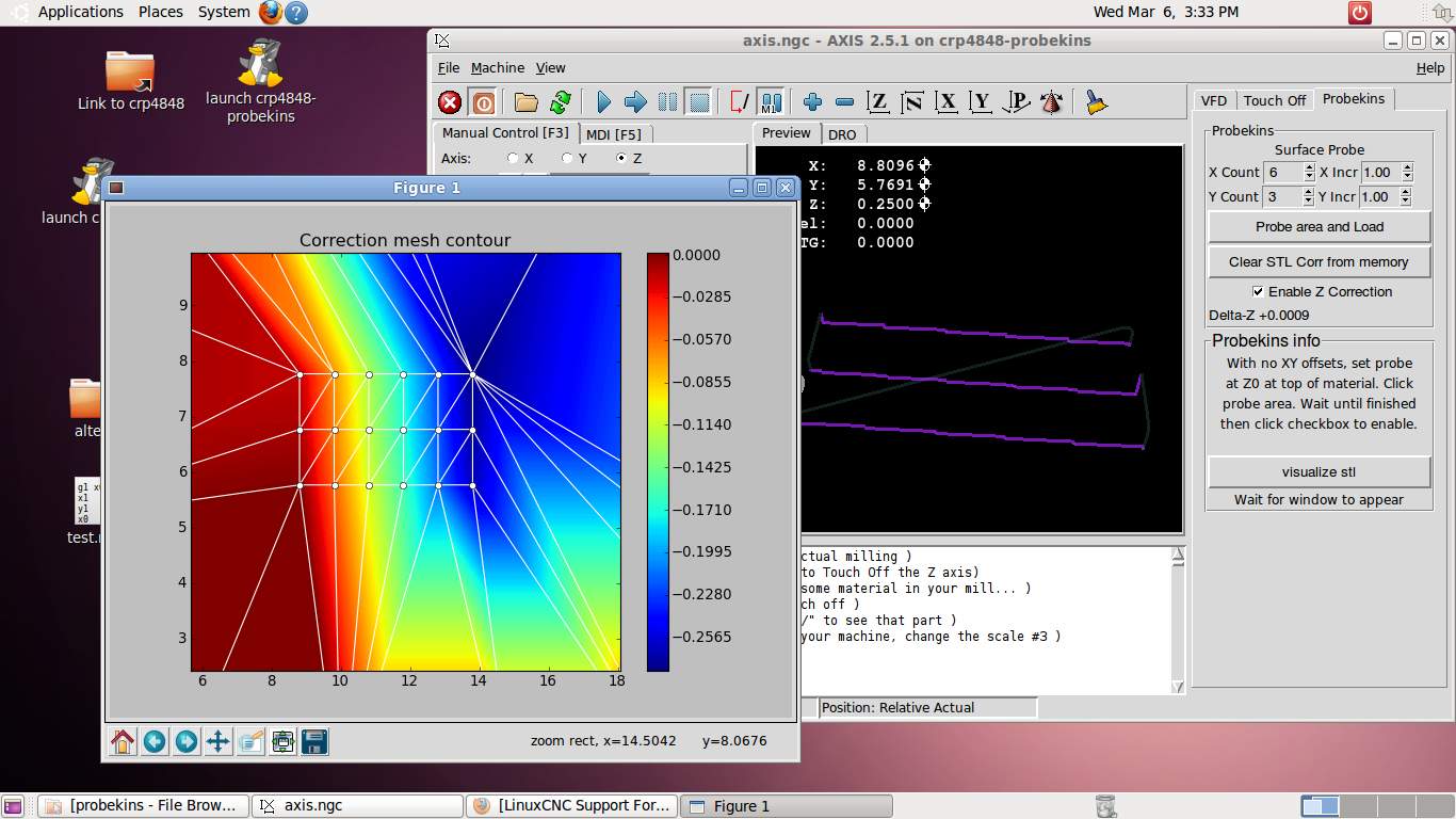

05 Mar 2013 00:23 #30856
by alan_3301
Replied by alan_3301 on topic Compiling probekins and using probe2stl
Back on this now. I have everything set up and working, except then my z correction is going the wrong way.
I use a gcode to probe a surface, storing the coordinates in probe.txt
probe2stl then converts to a stl, and then loads into memory.
there is a pin delta-z that corrects the Z based on the stl in memory.
I have setup a tilted piece of aluminum as my surface, highest on the left, and low on the right.
I touch off on the left side @ Z0. delta-z agrees with this as it is 0 at my starting point.
when I jog over to the right side, delta-z reads as it should with the value decreasing, however the Z axis will move up instead of down??

05 Mar 2013 00:43 #30859
There is no need for the extra variable (and there will be trouble if you fail to declare it).
C supports the "unary minus" operator (As does LinuxCNC G-code, but not typical G-code)
*(haldata->delta_z) = -t;
Ought to work.
Are you sure that your changes are compiling and working correctly? It can be surprisingly hard to tell.
Is your Z axis set up with higher numbers at the top and lower numbers at the bottom? That is the convention, and may be assumed by probekins.

05 Mar 2013 05:49 #30882
by alan_3301
Thank you both! Andy you had it right.
I was changing what was in /usr/realtime-2.6.32-122-rtai/modules/linuxcnc/ but it was looking at the copy in ~/linuxcnc-dev/rtlib/
To get delta-z to read right, and the machine to move right the lines for me ended up as:
