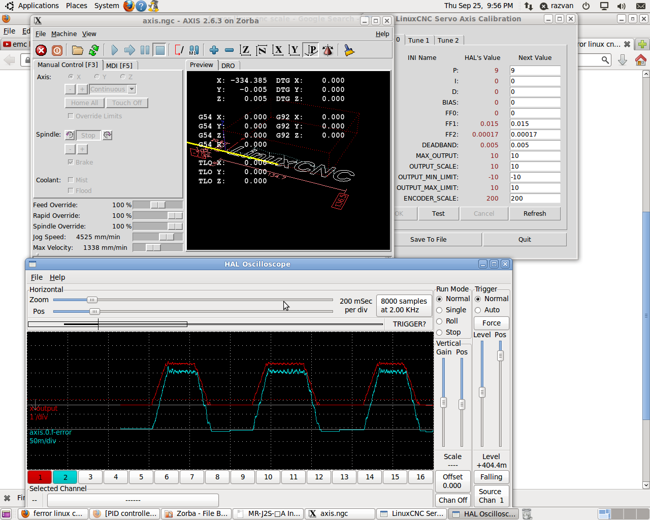

29 Sep 2014 21:55 - 29 Sep 2014 22:18 #51658 by crisiacuf@yahoo.com
Replied by crisiacuf@yahoo.com on topic Step or velocity control for servo gantry
Hello again, insufficient funds made me do some real work but I'm "back in gantry" now :D
I tried the partial PID loop but couldn't decrease the ferror much.
I changed the command system to velocity and I am now using a 5i25+7i77+7i78(not used for now) mesa setup.
My melservo MRJ2S's are conected to the +/-10V analog drive of the 7i77.
Without canceling the auto tuning in the servos I got a ferror of about 0,2mm @ 4500mm/min on the X axis. I only used P, FF1 and FF2(I spent a couple of hours trying to adjust I and D with no succes).
I don't know if it's better to completely disable the servos auto tuning but I will try soon.
What ferror would be acceptable at this speed for metal work?
Now I need to setup the gantrykins for the dual Y joints.
I'm considering using the ICECOLD(DaBit) gantry config files but don't really understand what's in them for now(although I read the related post).
Any sugestions or guidelines?
Last edit: 29 Sep 2014 22:18 by crisiacuf@yahoo.com.

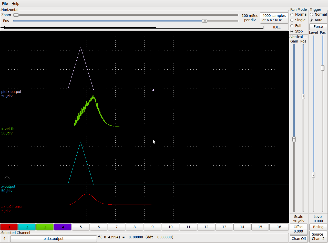

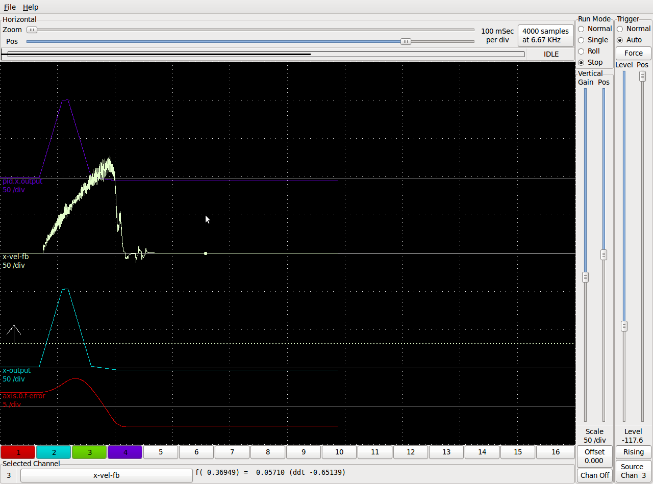

29 Sep 2014 22:17 - 29 Sep 2014 22:24 #51660 by DaBit
Replied by DaBit on topic Step or velocity control for servo gantry
Funny, I had a re-tuning session myself yesterday after straightening the ballscrews, finishing the Z-axis column (it gained 'a bit' of weight since initial tuning) and switching to fixed-fixed ballscrew bearing configuration.
This is the two Y-axes running the gantry in 'pure machine torture' mode: 1,1G acceleration, 200mm/sec. Accelerating ~150kg of steel and stone so fast feels like a giant is thumping the machine with a big sledgehammer. But it does exaggerate the effects of FF1/FF2.
My X axis is a bit more sloppy than Y.
X does 819 pulses/mm on the motor encoder, 200 pulses/mm on the linear encoder. Y does 1229 pulses/mm on the motor encoders, 1000 pulses/mm on the linear encoder and the 400W servos on Y are far more dynamic than that 750W beast on the X.
How are your servos setup? Position mode? Velocity mode? Torque mode?
Last edit: 29 Sep 2014 22:24 by DaBit.

29 Sep 2014 22:20 #51661 by crisiacuf@yahoo.com
Velocity mode
