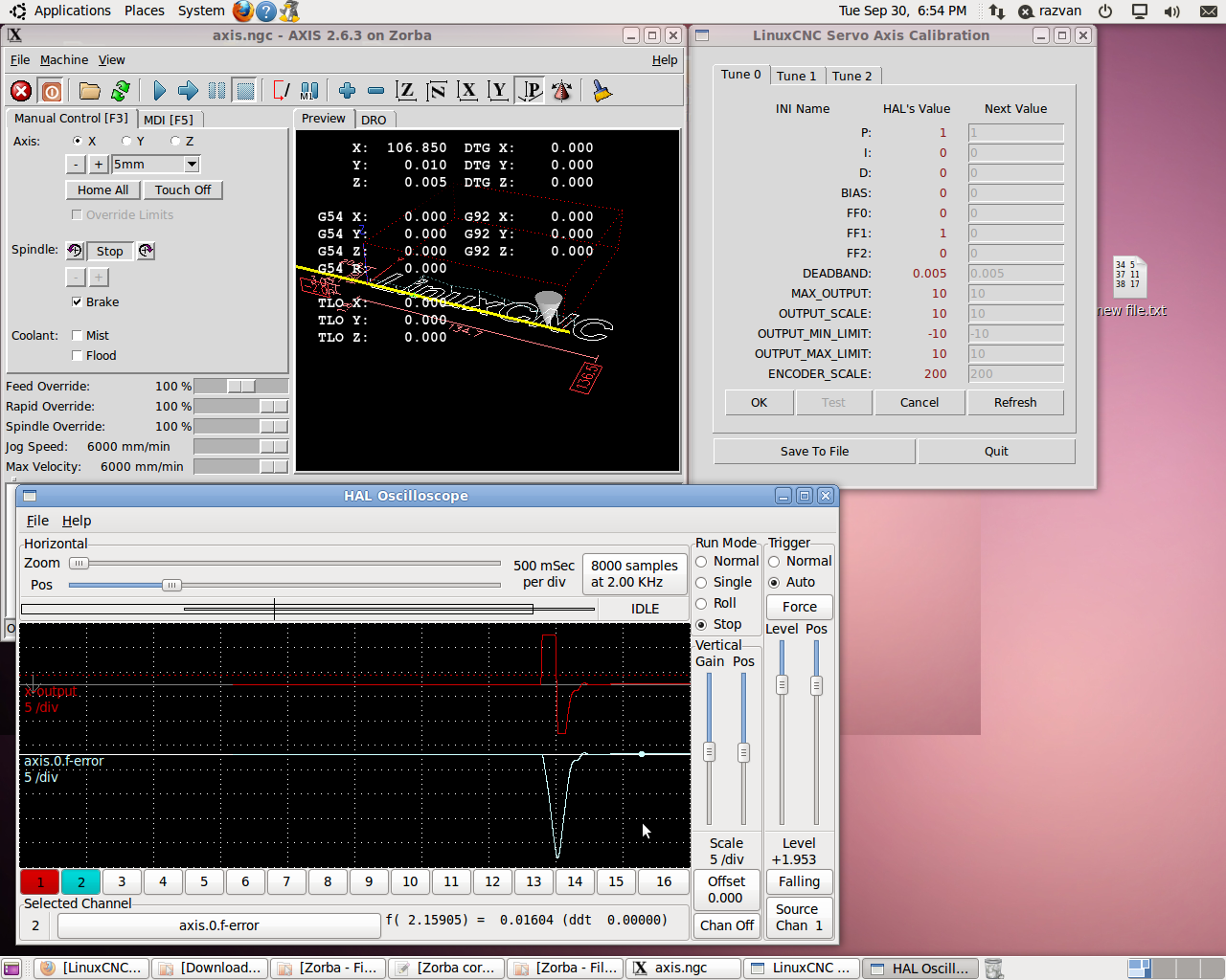

It seems I have the PID setup corectly but when I make FF1 = 1 this happens:
Here is my HAL for X axis:
What linuxcnc version do you have? My head hurts trying to compare my hal with yours

Replied by PCW on topic Step or velocity control for servo gantry
FF1 =1
only makes sense if your output scale is in machine units per second at full scale
So for analog velocity mode drives the output scale (= scalemax and maxlim and -minlim for 7I77)
= how fast your axis move in mm/s at 10V velocity command

What PCW said. And you seem to be using only the scale as position feedback. This is going to be pretty hard and will result in a sluggish loop at best since you only have 200 pulses per millimeter to work with and any form of nonlinear mechanics will bite hard. And since metal is not infinitely stiff and nothing can move without play the nonlinearity is there. Maybe small, maybe not, but it is there.
On my mill the encoder on the motor and lead of the screw is the primary positioning method. The scale is only used to correct residual errors and it does so only 'slowly'.
Forget about the scale at this point and make the servo work flawless without it first. Thinking about adding the scale to the positioning loop before that makes no sense.
I am running 2.7.0~pre BTW, but that does not matter. It would work the same with 2.5 or 2.6, especially if you set pid.x.error-previous-target=1

My axis moves at 25 mm/s @ 1V measured
My encoder velocity corectly shows 25.xxxx @ 1V
Max speed is 250mm/s @10V

Then make:
[AXIS_0]OUTPUT_SCALE -> 250
[AXIS_0]OUTPUT_MIN_LIMIT -> -250
[AXIS_0]OUTPUT_MAX_LIMIT -> 250
and make sure that the axis moves with 10mm/sec in one direction when you set hm2_5i25.0.7i77.0.1.analogout0 to 10 and 10mm/sc in the other direction when you set hm2_5i25.0.7i77.0.1.analogout0 to -10
Did you also connect the rotary encoder outputs of your servo drive to the 7i77? If not you should do so. Once again: forget about the scale for now, and get that servo running properly first.
