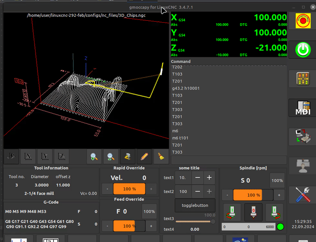

3. Question: Before we started modifying 'index_lathe_tool_with_wear' did the adding of wear tool offsets work for you but just the physical toolchange on the lathe did not work?
4. I've had a play around with 'index_lathe_tool_with_wear ' as remap for T on my simulation PC and I've noticed that the wear offset would only be added to the tool offset for a moment and then revert back to the pure tool offset. Do you get this as well?

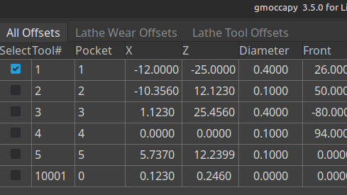

I have sometime issue with precision after tool change +-0.01mm with OWT grinded tool post fixtures with manual toolchange .hal stuff.. I noticed that in the default tool table for lathe is not the waer offsets .. I can switch on them by
where I can define them for the each tool separately
And then add the the remapping ?
Then I will need to change T1 G43 to T01XX in the postprocessor I think ..

If I want to fanuc style tool offsets .. I will do remapchange tool tablethen allow the wear offsets
all other files have to be in the same folder too?
I want to move from 2.8.4 to 2.9.4 and I am searching for updates which should improve my life
thanks
[RS274NGC]
SUBROUTINE_PATH = ./:../
REMAP = T prolog=get_T_number ngc=toolchange
PARAMETER_FILE = sim-lathe.var
[EMCIO]
TOOL_TABLE = lathe-fanucy.tbl# for details see nc_files/subroutines/maco_instructions.txt
[DISPLAY]
LATHE = 1
BACK_TOOL_LATHE = 0
LATHE_WEAR_OFFSETS = TRUEall other files have to be in the same folder too?
thanks

usually you would have the files in your config folder but the main thing is that they can be found where the file paths in the ini file point to, so don't forget to add the [PYTHON] section and contents to your ini file and set the appropriate paths.
See the sim configs for how to set things up.
