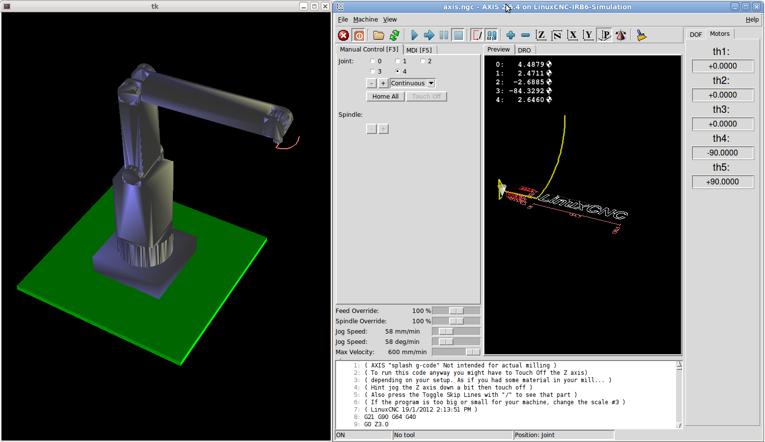

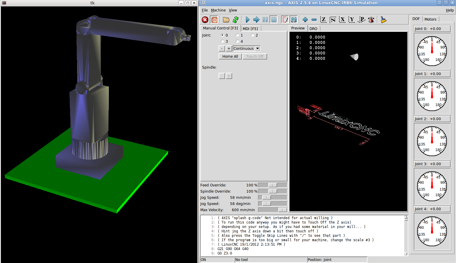

Hi Everyone,
Finally I can share with you the partial results of the manipulator robot simulation. Attach the files and some pics.
Basically, I use pumakins.c and modify the kinematics equations. When the real robot will be operating I'll do a detailed documentation for new and actual developers with manipulator robots interests.
I am still some bugs to revise, like:
- I don't know how set "world coordinates", I have error in the Inverse Kinematics function because doesn't has initial values. Something in the modified code from pumakins are generating it....... In the original puma configs didn't happen it.
Any suggestion or questions I will be attentive. Regards.

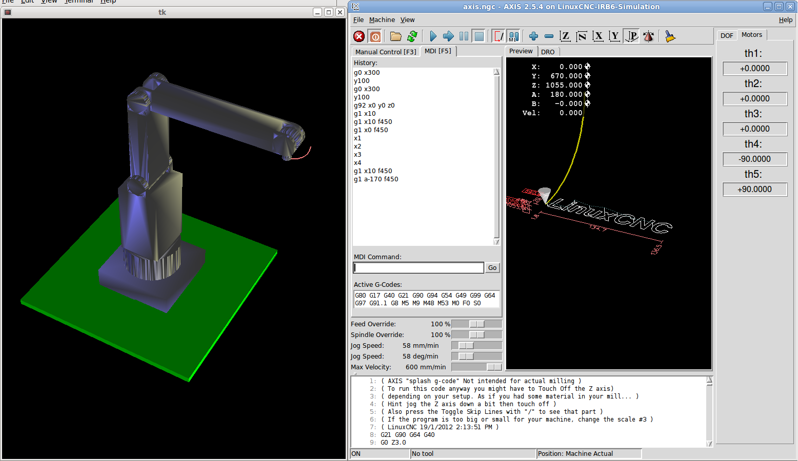

I will try to explain better:
1. Run LinuxCNC with my conf:
linuxcnc linuxcnc/configs/irb/irb.ini
2. "Toggle emergency stop and Machine power". Here is everything normal.
3. If I try to go at "MDI mode", my config generates error (puma560 and puma configs didn't happen it)
4. I have to push "Home all" in "manual mode", after that I can toggle to "MDI mode":
and the hal variables tha I created in the inverse_kinematics_function had been updated, but only in "MDI mode"
forum.linuxcnc.org/forum/10-advanced-con...tics-values?start=30
Only in MDI mode (World coordinates), the inverse kinematics function has updated values.
5. It's something happen with the inverse kinematics function, the flags or in the kinematicsHome() function... I modified something or I have to add something for a desired response. I have to fix it before run with the real robot and avoid some wrong behavior.
Thanks for the contributions, I want to improve the open architecture concept to control manipulator robots.

01 Dec 2015 11:23 #66158
I think this is normal. In "Joint Mode" the kinematics are not used. The Kinematics are only used in World Mode.
Homing nontrivial kinematics is not something I know much about.
Replied by andypugh on topic Manipulator Robot IRB6-S2 Simulation - pre
