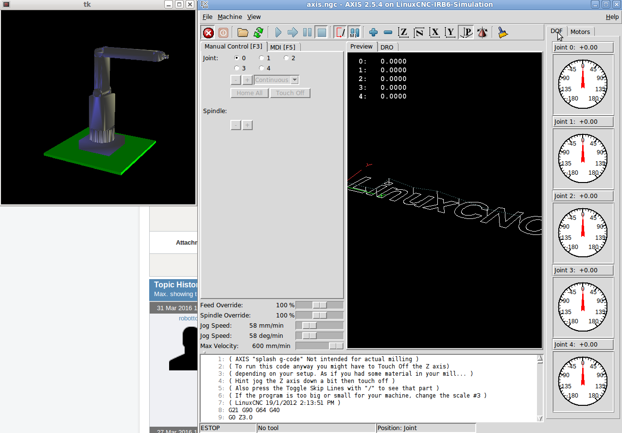

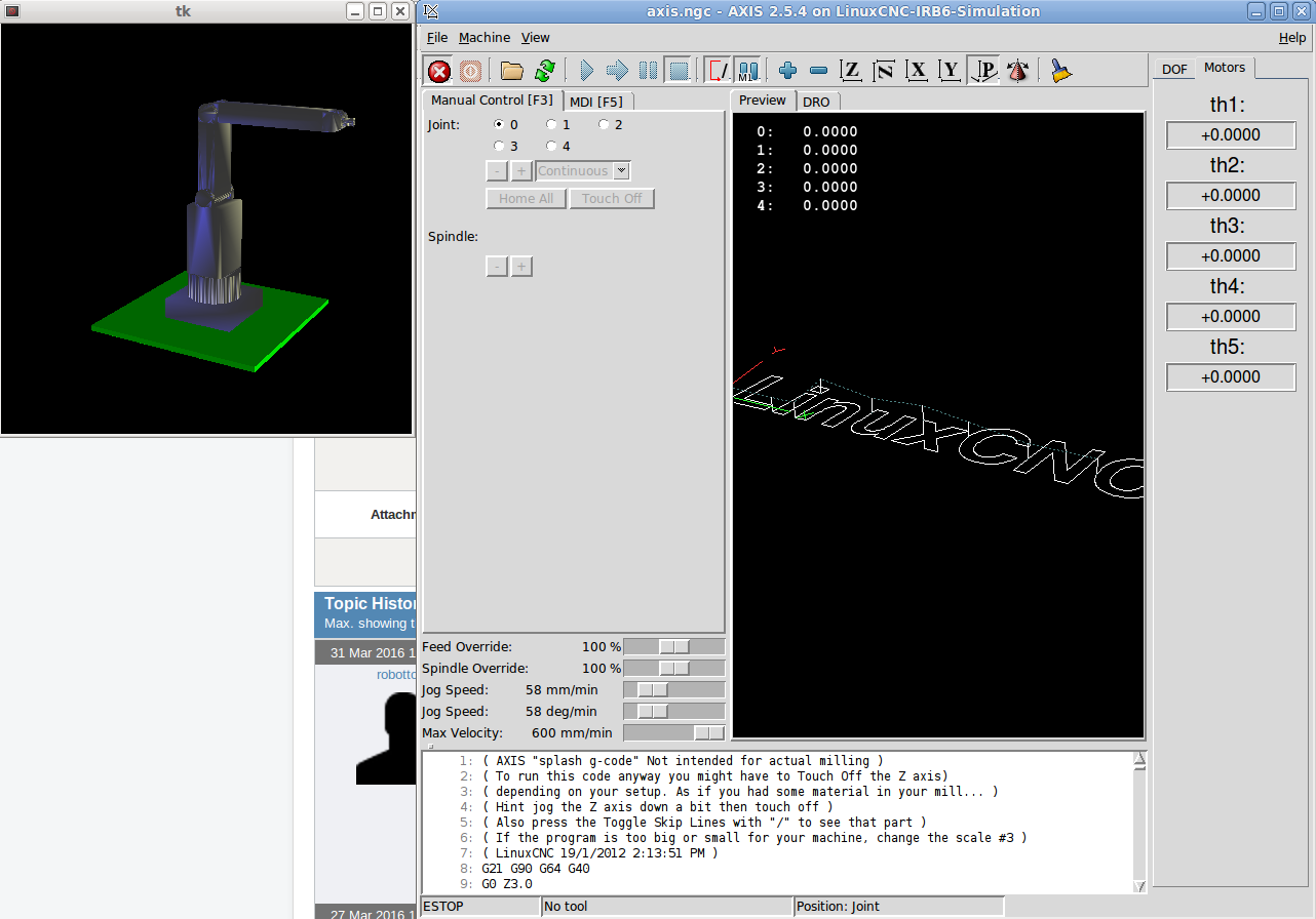

I'm not sure if I understood you. Is "PUMA GUI interface" refering to the simulation screen where you see a model of the Puma arm (what might be implemented in Python) or are you talking about the AXIS GUI of the LinuxCNC that is used when you just copy the Puma configs comming with LinuxCNC. You said "I created some additional variables for do that, and I linked the new *.xml variables..." sound for me like the puma.xml file that comes with the standard puma config. Via the puma.xml you add additional screen elements to the AXIS GUI (e.g. meters or buttons or leds) which can also be used to control the joints of the robot.

04 Apr 2016 11:43 - 04 Apr 2016 11:43 #72698 by jstoquica
Replied by jstoquica on topic Manipulator Robot IRB6-S2 Simulation - pre
Hi robottom,
Yes, It is, but only for see some kinematics parameters.
