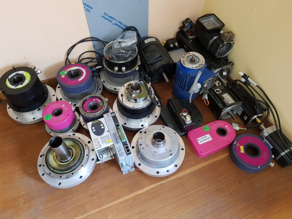

21 Jul 2019 12:10 #140069 by Stud54
Replied by Stud54 on topic TCP 5-axis kinematics
Damn, you did it first. My HDs are still laying in the corner...:)
21 Jul 2019 12:52 #140074 by plopes9000
Replied by plopes9000 on topic TCP 5-axis kinematics
Oh wow very nice collection, now I know why they are hard to get on eBay :-( you’ve been snatching them all ;-)
I still have another two but without integrated servo.
Despite what they say, better second than third;-) hurry up.
I had mine for about a year stored away, while the concept was brewing in my mind. If I knew where to get cheap custom casts I would have done it slightly different.
Nice thing is that the 5th axis can be swapped easily for any other setup, so it’s a modular design. While I’m exploring the current setup, many other ideas are brewing, many of which may never see the light of day.
