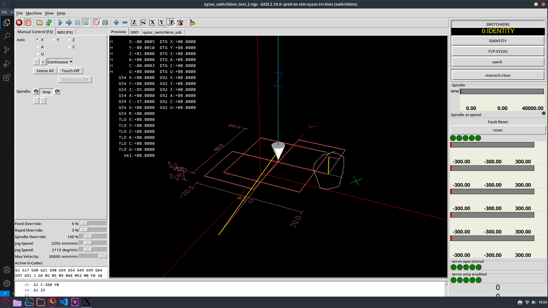

Greetings to all.
My 5-axis machines was running fine with the same INI, But as my Motherboard died and I changed my System and I also shifted my machines to other location.
Now my 5-axis TCP is not working properly as I can see a small jump simulation of Linuxcnc but in Machine there is no jump and because of this it derails from the actual path as you can see in Image.
Now I am not able to figure out why it is doing so..
I have attached my INI and HAL file.
Regards
Abhishek

If I understand correctly then the machine moves are correct but the tool path inserts the angled move. I'm not sure what you are using the 'U' axis for but you may want to remove that from the plotter and see if that fixes the issue:
Change this line
GEOMETRY = XYZ-ACU
to
GEOMETRY = XYZ-AC
Change this line
GEOMETRY = XYZ-ACU
to
GEOMETRY = XYZ-AC

Hi Aciera,
Thanks for the Reply.
I tried what you suggested but but there is no change in how the Machines shifts for actual trajectory because of shift in Linuxcnc simulation.
I am using Linuxcnc 2.10.0 Version.
Is it because of some glitch in Kinematics ?
Regards
Abhishek

Have you tested this on an unmodified 'sim/axis/vismach/5axis/table-rotary-tilting/xyzac-trt.ini' simulation configuration?
Replied by Aciera on topic TCP 5-axis kinematics
I doubt it, but I haven't tested 'sim/axis/vismach/5axis/table-rotary-tilting/xyzac-trt.ini' in 2.10 lately. I would expect this to be related to your use of the 'U' axis.Is it because of some glitch in Kinematics ?
