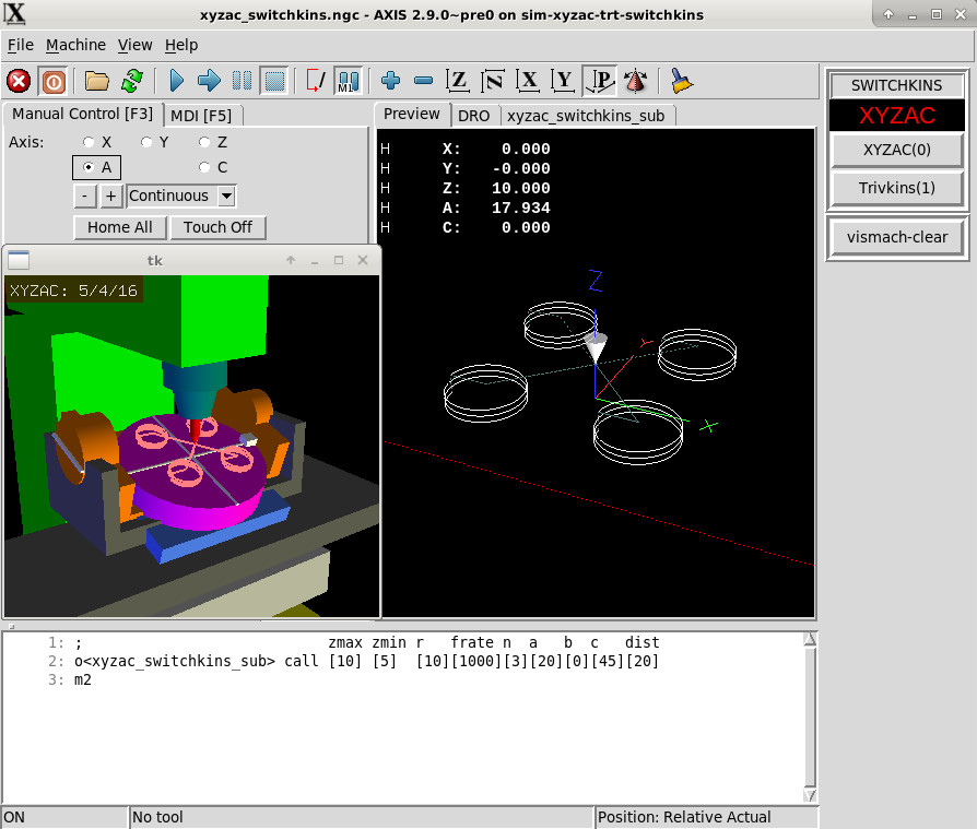

I've created a branch to test/demonstrate kinematics
switching (xyzac & trivkins, xyzbc & trivkins).
The branch is based on the original work of Rudy du Preez
and subsequent modifications by Rushabh, JSKangas, Plopes
(and probably others). The branch supplies kinematics
modules (xyzac-trt-switchkins,xyzbc-trt-switchkins) and
modifies the motion module.
The branch incorporates a simplified approach that
avoids changes to the interpreter, task, and nml.
Kinematics switching uses a new hal pin and existing
interpreter synching commands.
Summary:
1) A new hal pin (motion.switchkins-type) instructs a
candidate kinematics module to switch to a specified
kinematics type.
2) A gcode subroutine (switchkins.ngc) sets a motion analog
output pin netted to motion.switchkins-type and issues M66
(wait-on-input) commands to synchronize task and motion.
Since the code changes are limited to the motion module,
this branch presents a low risk for incorporation into the
master branch (if it survives user testing).
The branch is on github as dgarr/s_kins and includes
sim configs:
configs/sim/axis/vismach/5axis/table-rotating-tilting/xyzac-trt-switchkins.ini
configs/sim/axis/vismach/5axis/table-rotating-tilting/xyzbc-trt-switchkins.ini
Many aspects can be tested with the sim configs but
I lack equipment to do hardware tests. Interested
users are encouraged to respond to this thread with
testing results (or email me d g a r r e t t at panix dot com)
Ref: github.com/LinuxCNC/linuxcnc/commits/dgarr/s_kins

22 Nov 2019 20:04 - 22 Nov 2019 20:09 #150966 by dgarrett
Replied by dgarrett on topic TCP 5-axis kinematics
The simplified kinematics switching method using
the motion module hal pin motion.switchkins-type
requires a user to:
   a) add a subroutine (switchkins.ngc) in a proper
      location per [RS274NGC]SUBROUTINE_PATH (specify
      one of the available analog-out hal pins)
   b) make a hal net like:
      net :kinstype-select <= motion.analog-out-03
      net :kinstype-select => motion.switchkins-type
     (above is for use of analog out pin 3 in
      switchkins.ngc):
Then the command to switch within gcode is:
o<switckins>call[mode]
where:
mode==0 for default kinematics (xyzac,xyzbc)
mode==1 for trivkins kinematics
In the provided sim configs:
[RS274NGC]SUBROUTINE_PATH=./examples
So the switckins.ngc file is:
github.com/LinuxCNC/linuxcnc/blob/dgarr/...mples/switchkins.ngc
Other files in the same examples directory should work too:
github.com/LinuxCNC/linuxcnc/tree/dgarr/...ary-tilting/examples
Some may require touch off for Z, see:
github.com/LinuxCNC/linuxcnc/blob/dgarr/...otary-tilting/README
The sim configs gui includes buttons and
a label display to:
1) set to XYZAC (or XYZBC) via a halui mdi pin
or
2) set to trivkins via a halui mdi pin
3) Display the current active kins type
These may be useful for testing using jog
buttons (after homing of course)
Last edit: 22 Nov 2019 20:09 by dgarrett. Reason: Add notes on sim config buttons/label
