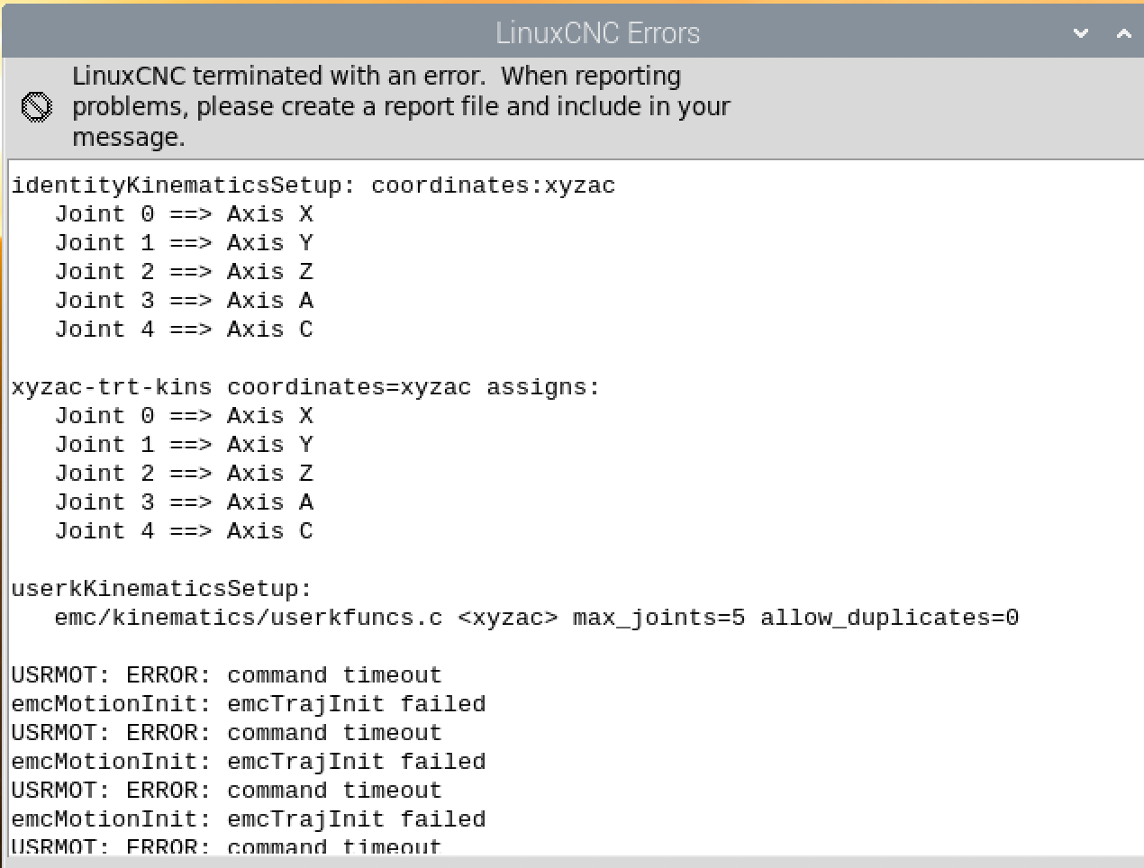

KINEMATICS = xyzac-trt-kins
If I change the JOINTS = 5 to 6, show the attached errore.
I'm not familiar with programming, but I set it up one year ago.

06 Jul 2021 14:06 - 06 Jul 2021 14:17 #213856
Replied by Aciera on topic TCP 5-axis kinematics
Are you running the recent version of switchable kinematics (ie s_kinsV2 or current master) ?
Also please attach your hal and ini files.
[edit]
I just checked and the recent version should report:
So it seems to me that you need to build current master to proceed further.
[edit]
userkKinematicsSetup:
emc/kinematics/userkfuncs.c max_joints=16 allow_duplicates=1So it seems to me that you need to build current master to proceed further.

06 Jul 2021 14:20 - 06 Jul 2021 14:35 #213858
by dgarrett
Replied by dgarrett on topic TCP 5-axis kinematics
To use multiple joints for an axis letter with xyzac-trt-kins,
you need a very recent (after 19jun21) build of the master
branch which incorporates:
github.com/LinuxCNC/linuxcnc/commit/135b0ce52
Suggest:
0) install current master branch from buildbot
(or build as RIP)
1) first test the demo config:
select the demo xyzac-trt config from the directory:
configs/sim/axis/vismach/5axis/table-rotating-tilting
$ linuxcnc xyzac-trt.ini
2) Copy the demo ini file:
$ cp xyzac-trt.ini test.ini
3) Edit the test.ini file to specify coordinates=xyzacy for:
x: joint_0
y: joint_1,joint_5
z: joint_2
a: joint_3
c: joint_4
Example modifications:
[KINS]
KINEMATICS=xyzac-trt-kins sparm=identityfirst coordinates=xyzacy
JOINTS=6
# modify JOINT_1 for HOME_SEQUENCE:
[JOINT_1]
HOME_SEQUENCE = -1
# new section for JOINT_5:
[JOINT_5]
HOME_SEQUENCE = -1
Attached is an example test.ini
