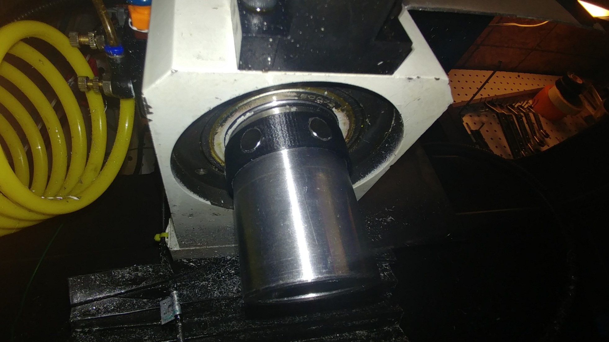

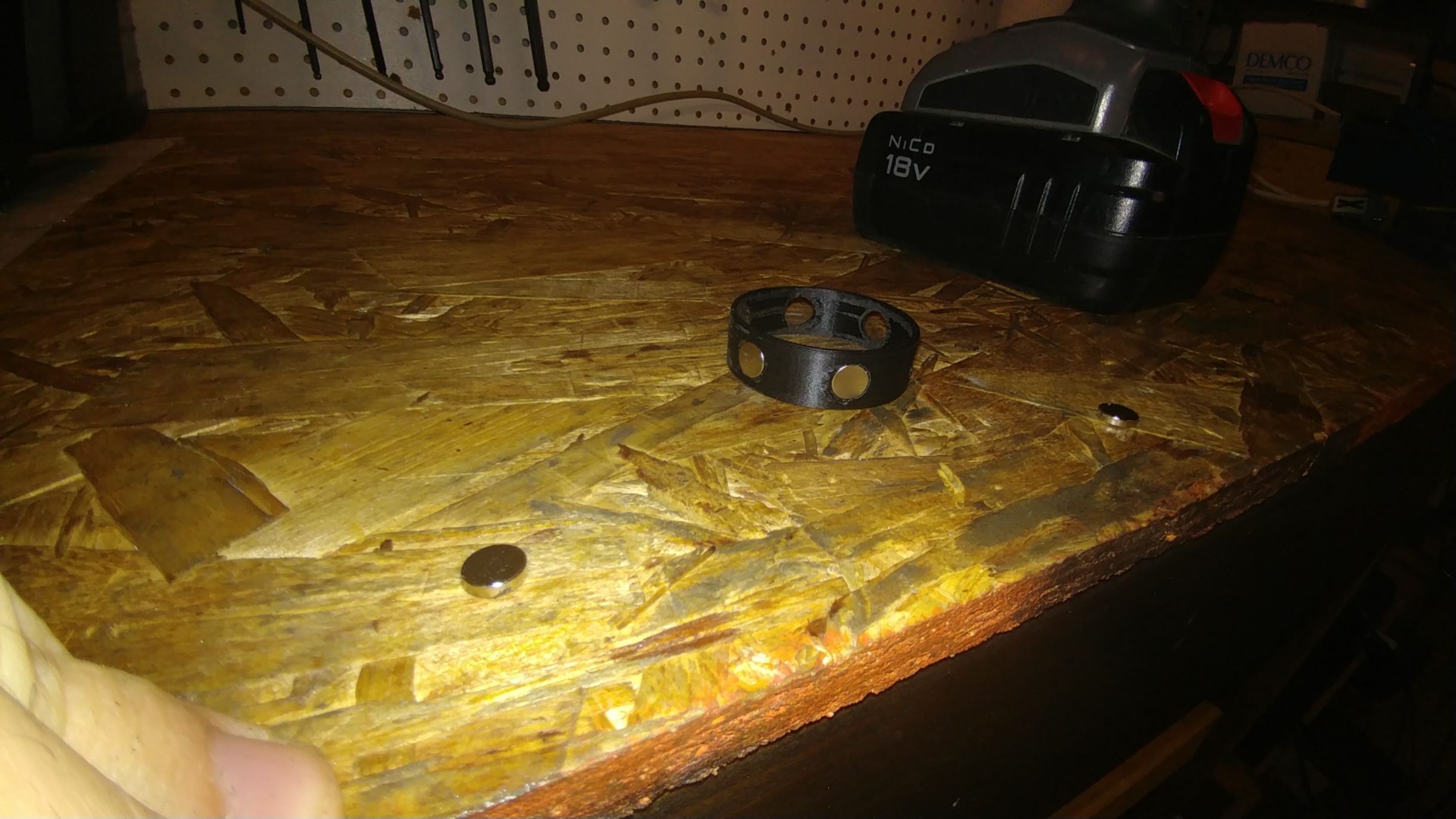

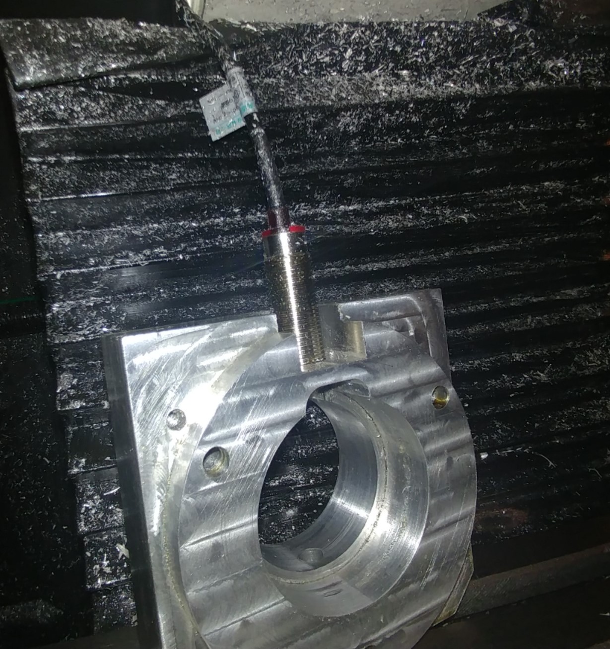

My Encoder design:
Here are the cad files for the sensor mount. It fits on the LMS 3990 mill, not sure if it will work on others.
Spindle Lock Cap
Main Sensor Body
Sensor Ring
Spindle Lock Cap
Main Sensor Body
Sensor Ring
