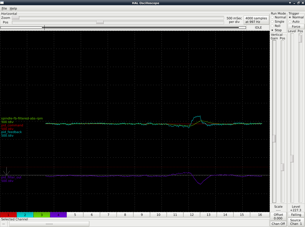

26 Nov 2017 17:57 #102358
by danimal300
Replied by danimal300 on topic Designing Spindle PID
One more question, I designed a quick test With a dull old end mill and ran a pretty aggressive HSM adaptive clearing path. I did some hal scope analysis, and caught this wave form right as it entered the corner of a pocket. It is a decent disturbance, but I wanted to see what others thought about the controller response.
It overshoots by about 200RPM above, might be due to it entering the corner and the spindle spools up as it exits causing the overshoot. Otherwise It was not too bad. Thoughts on the controller response?
26 Nov 2017 19:17 #102361
Replied by andypugh on topic Designing Spindle PID
Could be I-term wind-up.
You might want the PID terms to be asymmetric around zero error, if the spindle speed authority is different in accel and decel directions.
