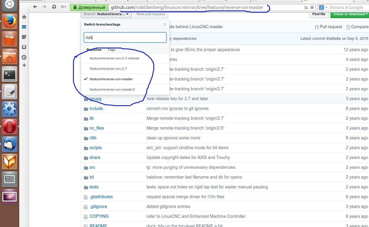

There is an experimental branch that allows for negative adaptive feed
github.com/LinuxCNC/linuxcnc/tree/feature/reverse-run-master2
(you replied to my video.)

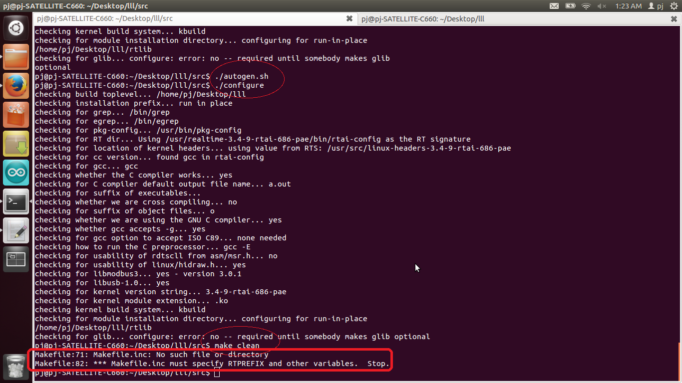

Dear
first of all thanks to respond but i am facing some problem with above files.
i downloaded above file and try to follow install process but when i executive "make" command i found below error
Makefile:71: Makefile.inc: No such file or directory
Makefile:82: *** Makefile.inc must specify RTPREFIX and other variables. Stop.

03 Oct 2017 21:08 #99851
Replied by andypugh on topic Executive G-Code in reverse direction.
I think it sounds like you either missed out the ./configure stage or failed to define a --with-realtime= parameter that matches your realtime kernel.

thanks Andy,
but first of all i ran ./configure file after that i ran "make" command but it is showing same error. i followed a process which is given in "install" file. but still facing same error.

05 Oct 2017 11:38 #99953
Do you have a realtime kernel?
What does "git branch" say? Also "uname -a"

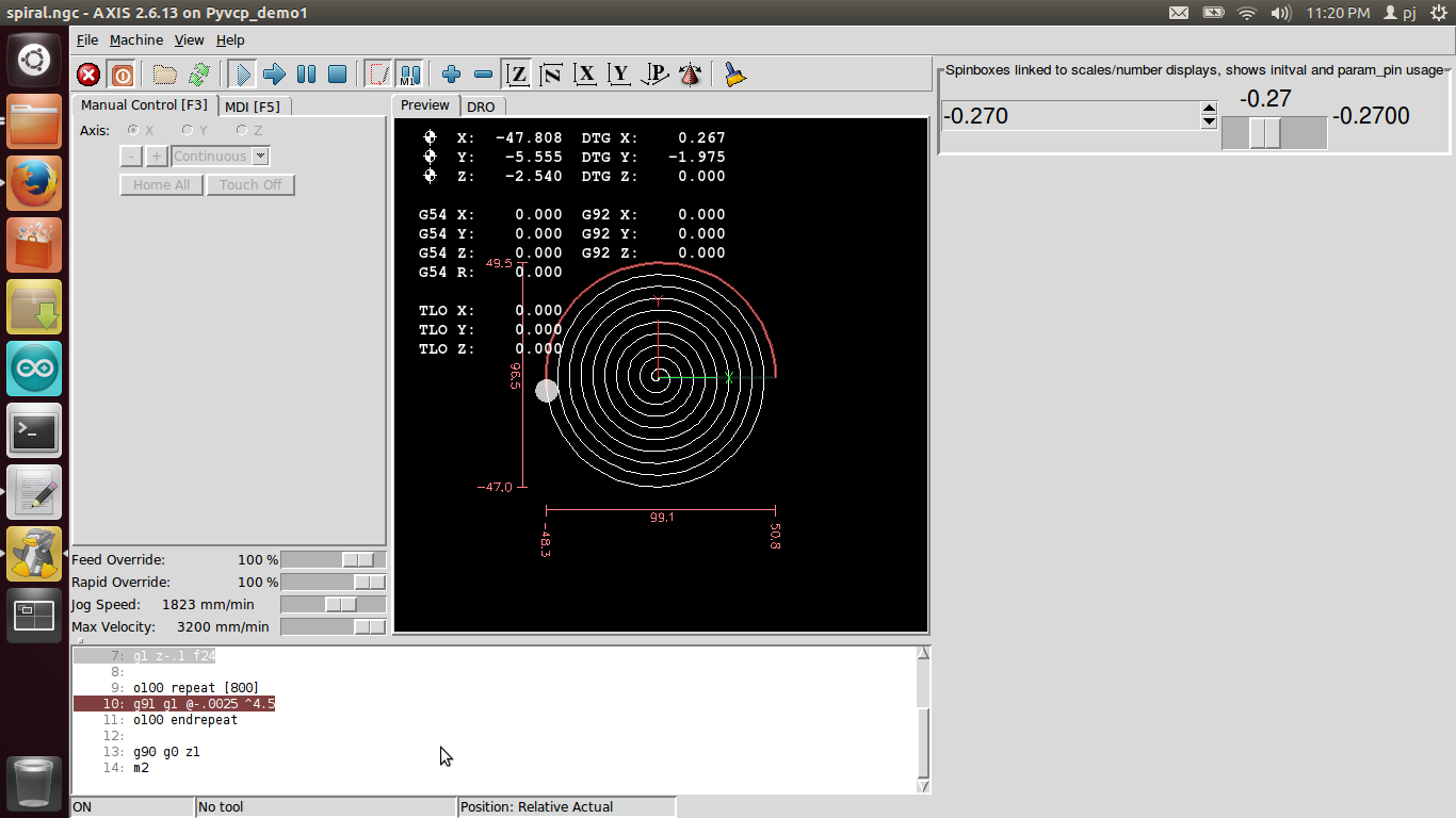

Dear skunkworks
i connected hal pin with my scaler and gave negative value but and also enable adaptive feed by M52 P1 but it is not going to reverse direction..... when my scaler is going to 0....moment is stopped and.......... when i gave positive value it move forward move...... but when i gave negative value it will stopped instated of moving in reverse direction.

15 Oct 2017 19:23 #100409
by nkp
Replied by nkp on topic Executive G-Code in reverse direction.
The following user(s) said Thank You: parth1799
