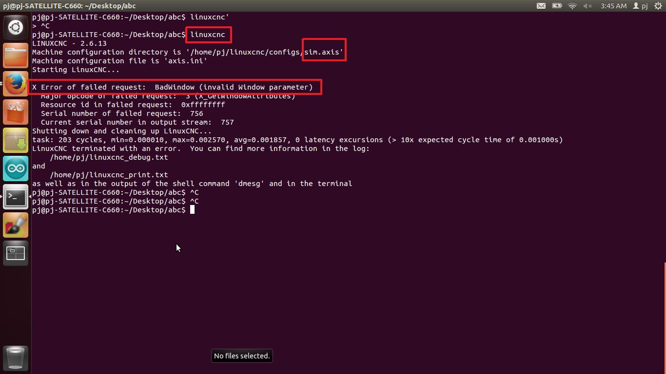

but now i am facing one more error when i run linuxcnc and i select axis i got error "X Error of failed request: BadWindow (invalid Window parameter)"
pls guide me what to do with this error.
20 Oct 2017 18:48 #100589 by andypugh
Replied by andypugh on topic Executive G-Code in reverse direction.
Did you get anywhere with this? I have only seen that problem when using X-forwarding on ssh and nearly all the Google hits on the error message are also related to remote forwarding of X windows.
