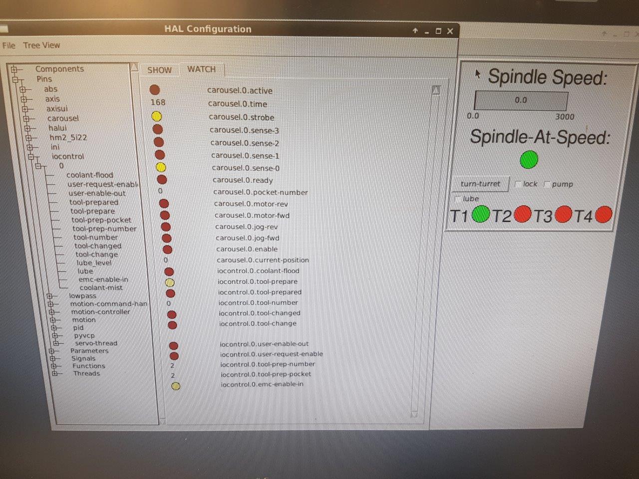

Good day All
more questions
MDI => T2 M6 activates iocontrol.0.tool-prepare + carousel.0.strobe
1)The carousel component sees the 4x proximity sensors. but does not register them in the carousel.0.pocket-number
2) Do we need a additional program to turn the turret twice : say T2 => T4
3) We probably need some sort of a delay between the hydraulic push- pull action that turn the turret.
no idea how to implement this
regards
Wilfried
more questions
regards
Wilfried
07 May 2018 18:14 #110335
Replied by andypugh on topic component compile problem
It sounds like carousel.0.strobe might be connected to the wrong thing if it toggles with M6 rather than with the carousel turning.
I am suspicious that carousel.0.active and carousel.0.enable are showing false. Perhaps you have forgotten to addf carousel.0 to a thread? What is carousel.0.enable linked to?

09 May 2018 16:01 #110438
by Skidloaders1
Replied by Skidloaders1 on topic component compile problem
Good day Andy
The carousel.0.strobe is always on , even before activating ( F2) linuxcnc
I even deleted the sense pin carousel.0.sense-0 , makes no difference.
extract from hal file below: the iocontrol is still a bit of a mess,i'm still learning
######### turret control ###############
loadrt carousel pockets=4 encoding=single num_sense=4 dir=1
addf carousel.0 servo-thread
# turn
setp hm2_5i22.0.gpio.091.is_output true
setp hm2_5i22.0.gpio.091.invert_output true
net turn-turret => hm2_5i22.0.gpio.091.out
# lock
setp hm2_5i22.0.gpio.092.is_output true
setp hm2_5i22.0.gpio.092.invert_output true
net lock => hm2_5i22.0.gpio.092.out
# hydraulic pump
setp hm2_5i22.0.gpio.094.is_output true
setp hm2_5i22.0.gpio.094.invert_output true
net pump => hm2_5i22.0.gpio.094.out
# proximity sensors input
net pos1 <= hm2_5i22.0.gpio.083.in_not => carousel.0.sense-0
net pos2 <= hm2_5i22.0.gpio.080.in_not => carousel.0.sense-1
net pos3 <= hm2_5i22.0.gpio.081.in_not => carousel.0.sense-2
net pos4 <= hm2_5i22.0.gpio.082.in_not => carousel.0.sense-3
##### toolchange signals for custom tool changer #####
net tool-number <= iocontrol.0.tool-prep-number
net tool-change-request <= iocontrol.0.tool-change => carousel.0.enable
net tool-change-confirmed => iocontrol.0.tool-changed => carousel.0.ready
net current-tool-number <= iocontrol.0.tool-number <= carousel.0.pocket-number
net enable-turret <= iocontrol.0.tool-prepare #=> carousel.0.active
regards Wilfried

09 May 2018 17:44 #110442
strobe = 1 is to be expected if it is not connected and you don't have a strobe pin from the tool changer.
(So that's OK)
Is iocontrol.0.tool-prepare changing state? That is typically activated by the T-command and is the enable input in your case.
github.com/LinuxCNC/linuxcnc/blob/master...onents/carousel.comp
Is the underlying code.
I think that you need "binary" rather than "single" for your machine. 4 sense pins and a single index makes no sense.
(So that's OK)
