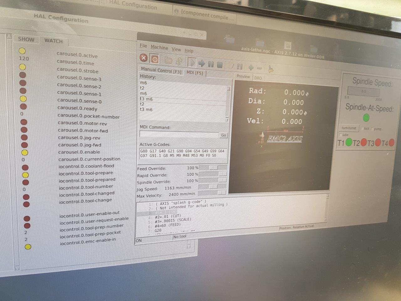

On my machine and using the carousel single option Tx activates iocontrol.0.tool-prepare but does not display the iocontrol.0.tool-number or carousel.0.current-position at all.
How can I get the carousel.0.current-position to work?
I tried to link the sense pins to various carousel or iocontrol pins without succes.
i followed your Sim-axis-axis suggestion and it worked flawlessly.
I learned that I have to home the axis's on my machine
In the sim Tx activates iocontrol.0.tool-change and iocontrol.0.user-enable-out and shows the correct iocontrol.0.tool-number

Do you have T re-mapped for lathe-style tool-changing?
It almost looks like carousel is stuck, and the fact that I don't see a parity pin might indicate that you are not using the latest version. (And the earlier version did have a way to get stuck)
Showing neither fwd nor rev but at the same time not asserting "ready" is a bit suspicious.
There is a HAL parameter which shows where the carousel state machine currently is.

What state is the carousel state machine in?

- Skidloaders1
- Posts: 43
16 May 2018 17:00 - 17 May 2018 16:01 #110792
by Skidloaders1
Replied by Skidloaders1 on topic component compile problem
carousel.0.state value = 0
Last edit: 17 May 2018 16:01 by Skidloaders1.
- Thank you received: 4654
18 May 2018 21:47 #110855
That's odd.
github.com/LinuxCNC/linuxcnc/blob/master...s/carousel.comp#L200
It should never be in state 0 if enable is true.
Does the carousel respond to jog buttons? (You can create fake jog buttons with sim_pin )
What is enable connected to? Is that changing state on tool-change?
Replied by andypugh on topic component compile problem
That's odd.
