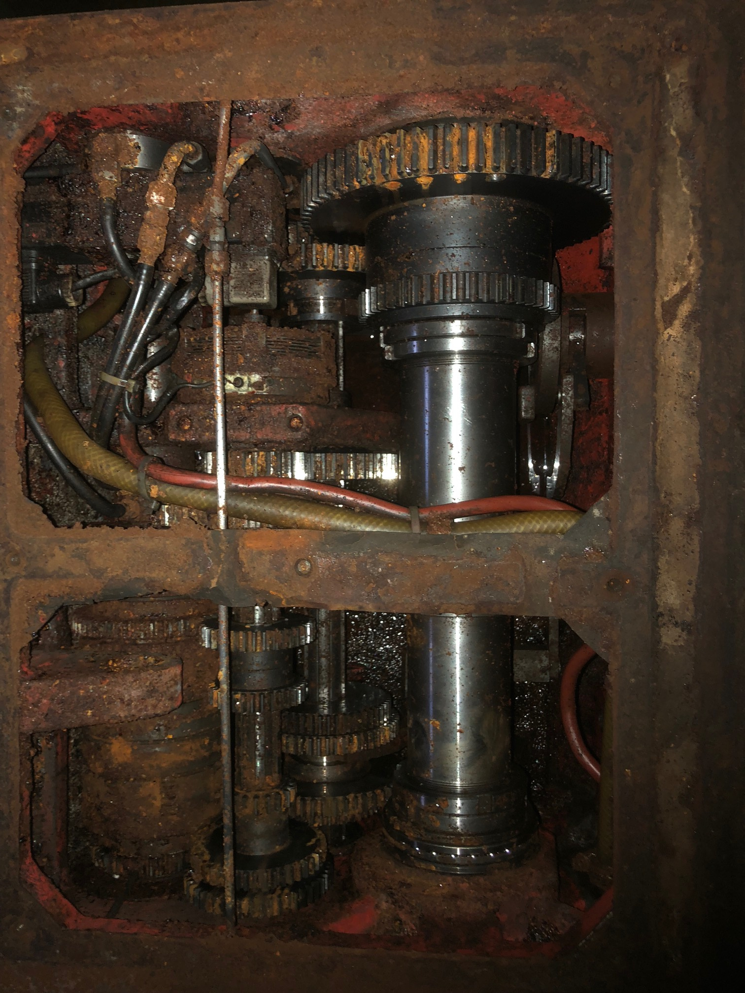

I consider to take a look at this machine because it was only 10km away from me...
But then i made the wrong decision and got a douple pack with nef 280 and nef 480.
i will retrofit the 280. The 480 was ok from the bed and the rest but at home i got a shock after a deeper lock
For the Gearbox and vfd i would write a specific component, like i did before for other retrofits.

Oh that looks nasty, sorry for that.
Mine was a workhorse a bit neglected but not really mistreated. (They bypassed the limit Switches and crashed, so there are some nasty marks on the chuck and sled ). The Gearbox looks much better than yours. I negotiated a bit on the price and they drove it over to me. So far no really bad surprises.
I never programmed a comp just some small bash and python scripts to get my Chiron running.
I will start easy and maybe later get more fancy hoping the motor survives. I it dies I guess I am in trouble.
