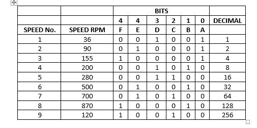

I'm automating a parallel lathe with a 9-speed gearbox selected manually using two levers, each with 3 positions: lever 1 has positions A, B, and C, and lever 2 has positions D, E, and F. The possible combinations are as follows: Direction changes are achieved by activating two electromagnetic clutches.This gives me the following truth table: I'm using the gearchange component for up to 32 speeds created by Andy Pugh, which can be used in this case. The first problem I encountered was creating the logic to detect these combinations, as I needed to detect the positions of the 6 switches I'm going to install to control the lever positions. Of the 6 bits, two will always be true. The component I found and was able to use was LUT5, but the problem is that it's only valid for 5 bits, and there are 3 combinations where bit 5 is one. Therefore, for these 3 combinations, in addition to LUT5, I had to use an additional AND2 gate to detect them.I read on the forum that for some automatic gear shifters, like the Maho MH400E, they created a component with an array that detects each gear by the switch positions.I also used the generic mux component to identify which gear was selected using a number between 1 and 9. Since it's 9 bits, it gave me a combination of 512, of which I only used 9 so that the mux output was a number between 1 and 9.I don't know if there's another way to detect the switch combination for the two levers.I've attached my HAL file to detect each lever position so I can send the correct speed to the VFD.

Sometimes a custom component simplifies your hal file. Here is my solution for a similar problem where there are two belts each with 4 positions. But because it's not possible for both belts to use the same position, it comes down to the same problem you have. For the ratios, I just ran the spindle on each belt combination and read the actual rpm with a cheap laser tacho and did some maths. But I did not have levers, and made a panel for qtdragon which Chris "borrowed" for the qtdragon docs.
github.com/rodw-au/vmnmillqt/blob/main/scalebelts.comp

Rather than LUT5 look at using a match_8 for each gear.
Alternatively, a mux_generic with 6 bit inputs could provide the gear number, or a pair of them could provide the speed limits.
Your HAL file would only need to define inputs for the valid gear positions, not for all 64 possibilities.
loadrt mux_generic config="ff64,ff64,ff64" names="gear,max,min"Please Log in or Create an account to join the conversation.
