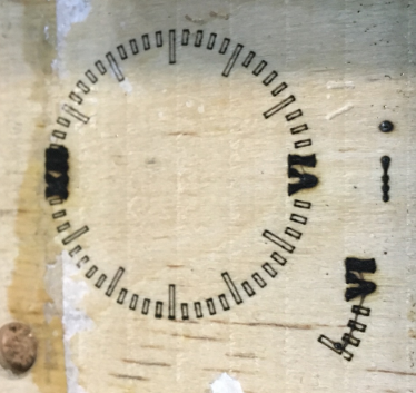

i have a few questions regarding the hal configuration for my current project: laser vector engraving.
I already managed to hook up a 2,5W laser to my 7i92, changed a few lines in a Fusion360 Postprocessor and can engrave with on/off commands.
The Postprocessor uses the 2D-Contour CAM module for plasma/waterjet/laser and simply turns on/off the laser with M62/M65. Postprocessor attached. Heres an example of my first laser engraving:
As you can see, the rectangles look ok, but the numbers are way too burnt. I think the problem is that there are too many lines with too many accelerations/decelerations in one spot. I think i can just model with fewer lines, but the acceleration and deceleration will still be a problem. To compensate for slower movements, i need to lower the laser power.
My next step would be to use a PWM to control my laser power. I would net my velocity to that PWM, If the velocity is high the laser power is high - if the velocity is small, the laser power is low. Everytime M62/M65 would come up the PWM gets enabled/disabled.
Since this is my first fairly complex hal experience, i would like to discuss it here. Does this hal-snippet looks somehow of what i described?
For testing i will set pwm_scale to 0.0017 since my max linear velocity is 34mm/s, which should result in the maximum PWM frequency and maximum laser power.

it looks close though the PWM scale should be something like maximum velocity
(in machine units/second) so you get 100% duty cycle at full speed.
( a scale of 0.0017 would mean full PWM at any velocity >= 0.0017 mm/s)
It might be helpful to use the scale component because it has an offset
and I would expect the PWM control of the laser vs marking to be quite
non-linear. If more complex linearization is needed, the lincurve component
could be used.

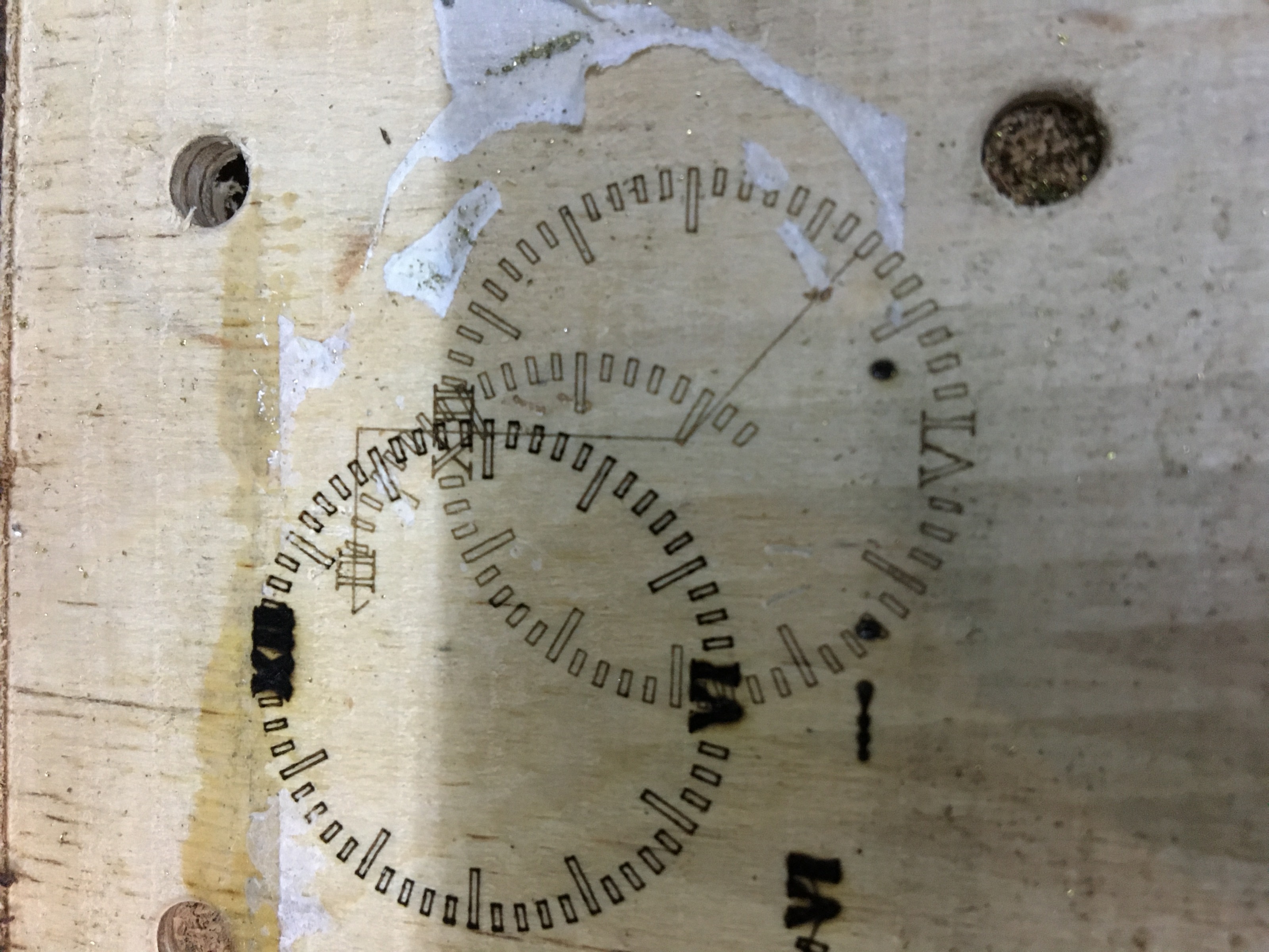

Thanks! I finally got to my shop and tested it. Some lines were incorrect or unnecessary, here is my current hal snippet:
Here is the result of that:
I need to do way more testing and fiddling, but that second engraving looks quite promising.
What i noticed:
loadrt num_dio=1
loadrt hm2_eth board_ip="192.168.1.121" config=" num_encoders=2 num_pwmgens=2 num_stepgens=4"
setp hm2_7i92.0.pwmgen.01.enable 0 #BIT enable PWM
setp hm2_7i92.0.pwmgen.pwm_frequency 20000 #float set ALL PWM frequencies
setp hm2_7i92.0.pwmgen.01.scale 34 #float Scaling factor to convert value from arbitrary units to duty cycle: dc = value / scale.
net laserintensity motion.current-vel => hm2_7i92.0.pwmgen.01.value #current velocity to PWM 1=1
net laseron motion.digital-out-00 => hm2_7i92.0.pwmgen.01.enable #When M62 is sent, PWM starts; when M65 is sent, PWM stopsHere is the result of that:
What i noticed:
- If my machine is stopped while it engraves, the laser turns "off". Thats because my velocity is 0 -> PWM is 0 -> laser power 0
- That may lead to dangerous situations where i emergency stop the machine, the laser looks like it's off, but if i jog afterwards it turns on. See the straight lines between the engravings. In short term i will use a external power switch for the laser for that
- The laser power looks like it's way weaker than the original engraving.
- I had a scale of 34, a max speed of 34mm/s but only engraved with 17mm/s, so there was only a 50% PWM output
- I will need to do more testing with my speeds, scale, maybe the offset parameters or lincurve.
