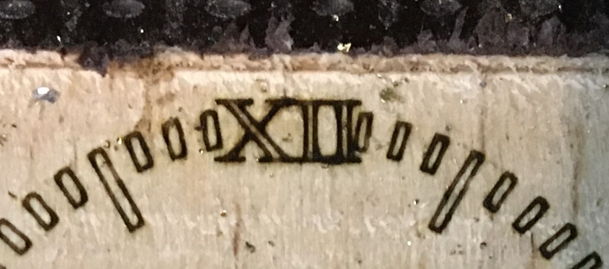

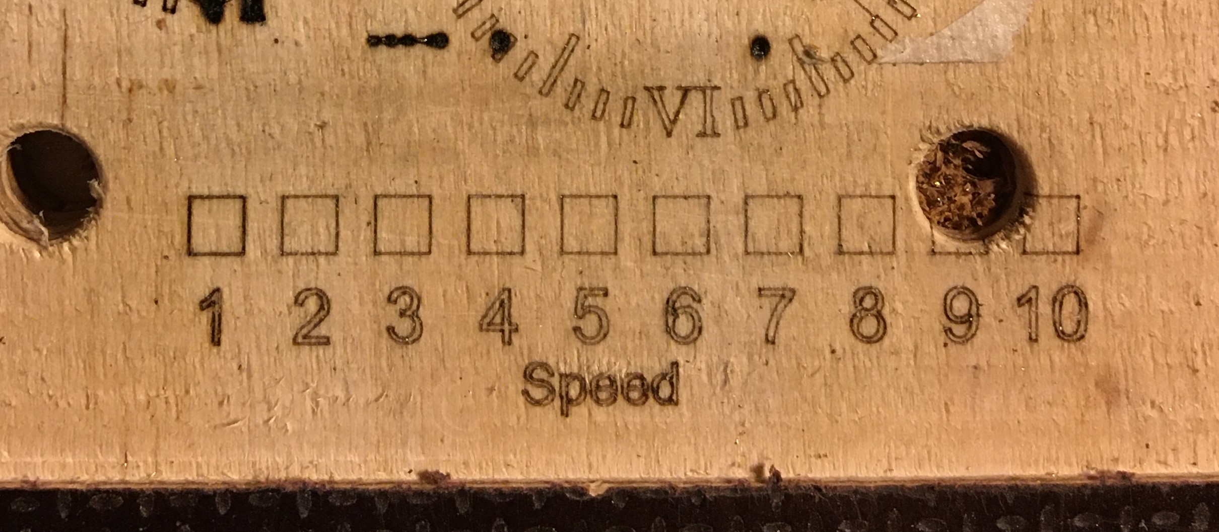

I got to test a few things yesterday, but first my current workflow for safety:
For now that is OK for me. In short terms i will use the LED on my powersupply as an indicator, in long terms i would like to test the active low PWM like described here: active low PWM
Now to the fun part:
I tested my PWM output and velocity linearity. I engraved a rectangle and a number where number 1 is engraved with 10% velocity, number 2 is 20% velocity and so on.
Number 1 looks way too burnt, number 7 a little weak. But all in all pretty linear. This is for now more than acceptable for my application. (engraving clock-faces)
As a reference: the rectangles are 0,5mm thick. The laser burn width is about 0,15mm.
