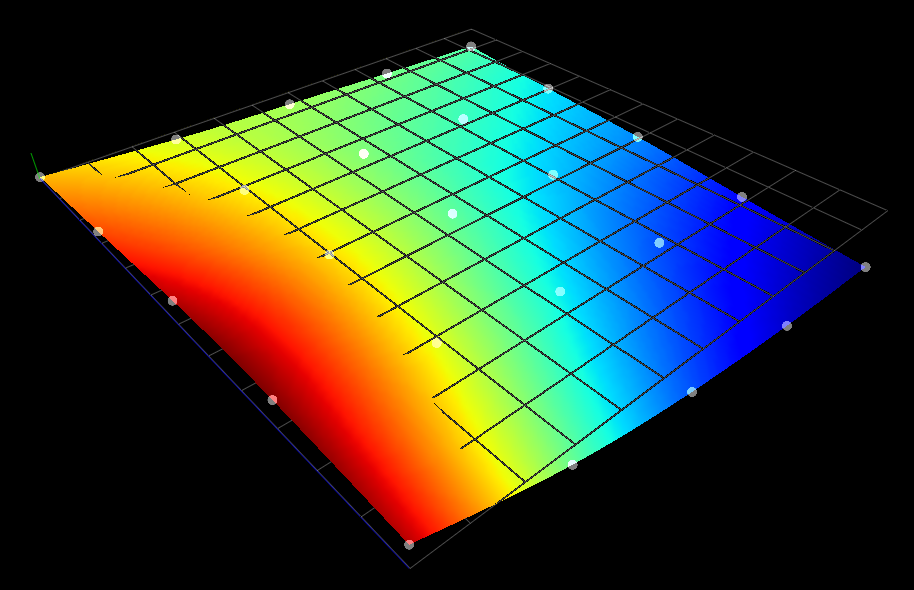

I've been using LinuxCNC with a RPi for 3D Printing for some years now. Along the way slowly developing functionality needed for a 3D printer. Bed levelling, I hope, is the last piece of the puzzle besides an integrated GUI.
I have found several approaches from over the years:
My first efforts were similar to the Probekins approach, but to use linear regression to map a quadratic surface to the surface probe data points and to use this within the kinematics to perform the correction. I had this working nicely but with one major drawback. As it is a surface of best fit there is errors at the probe points. Sometimes these errors defeat the purpose.
In another recent thread Andy Pugh made the suggestion:
"If I was doing this with current LinuxCNC I think I would still use the STL offset map, but would use a standalone HAL component that output a Z correction fir use by the external offsets inputs. "
Which got me back to the drawing board, and I'm happy to say that with the help of Covid-19 isolation I can share a Beta version of my compensation component that uses external offsets as he suggested, but uses interpolation to create a correction map.
I had added my compensation component to my GitHub and a short YouTube video of it in action. Some testers and feedback would be appreciated. The video shows this correction map in the picture above being applied.

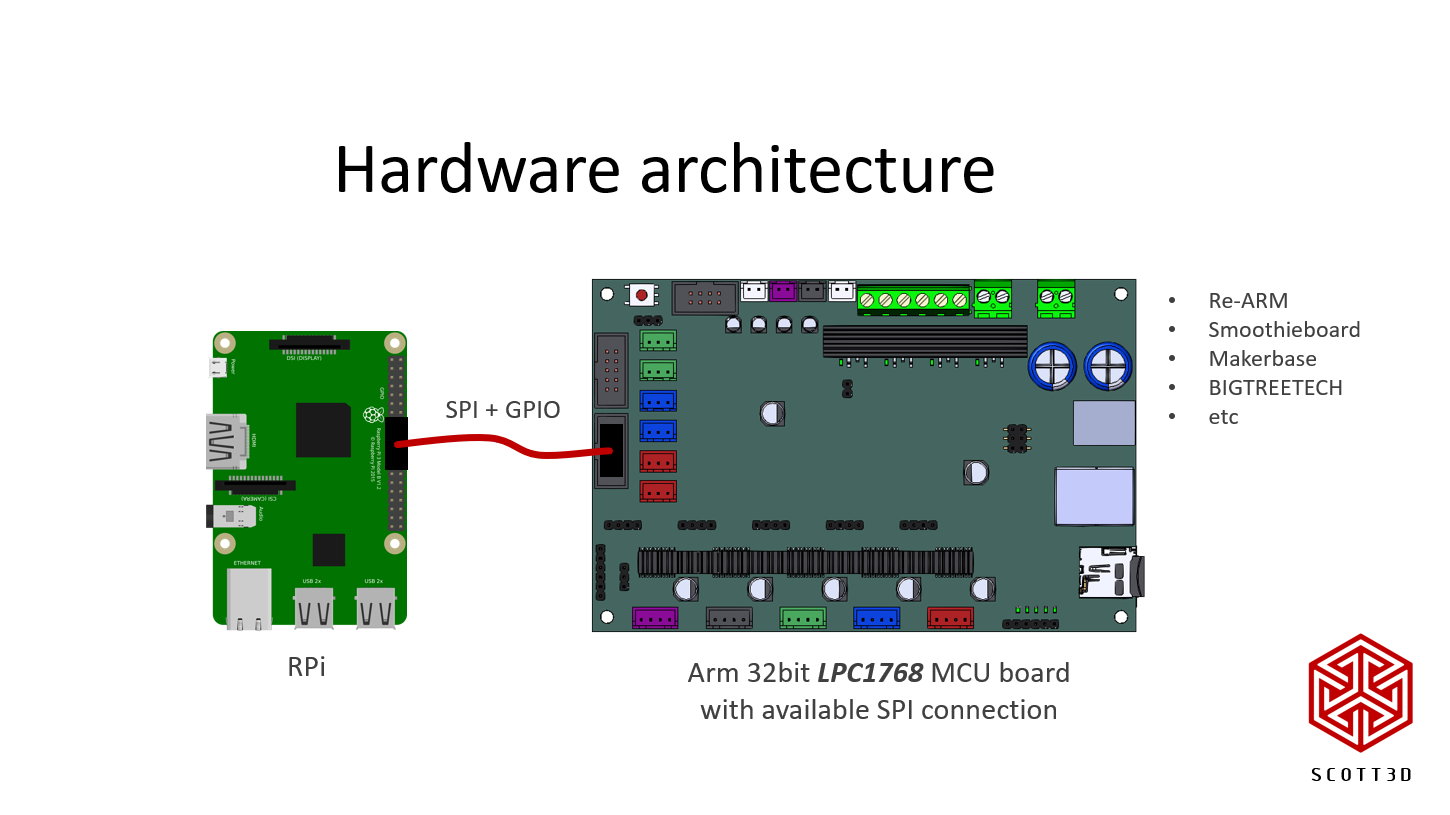

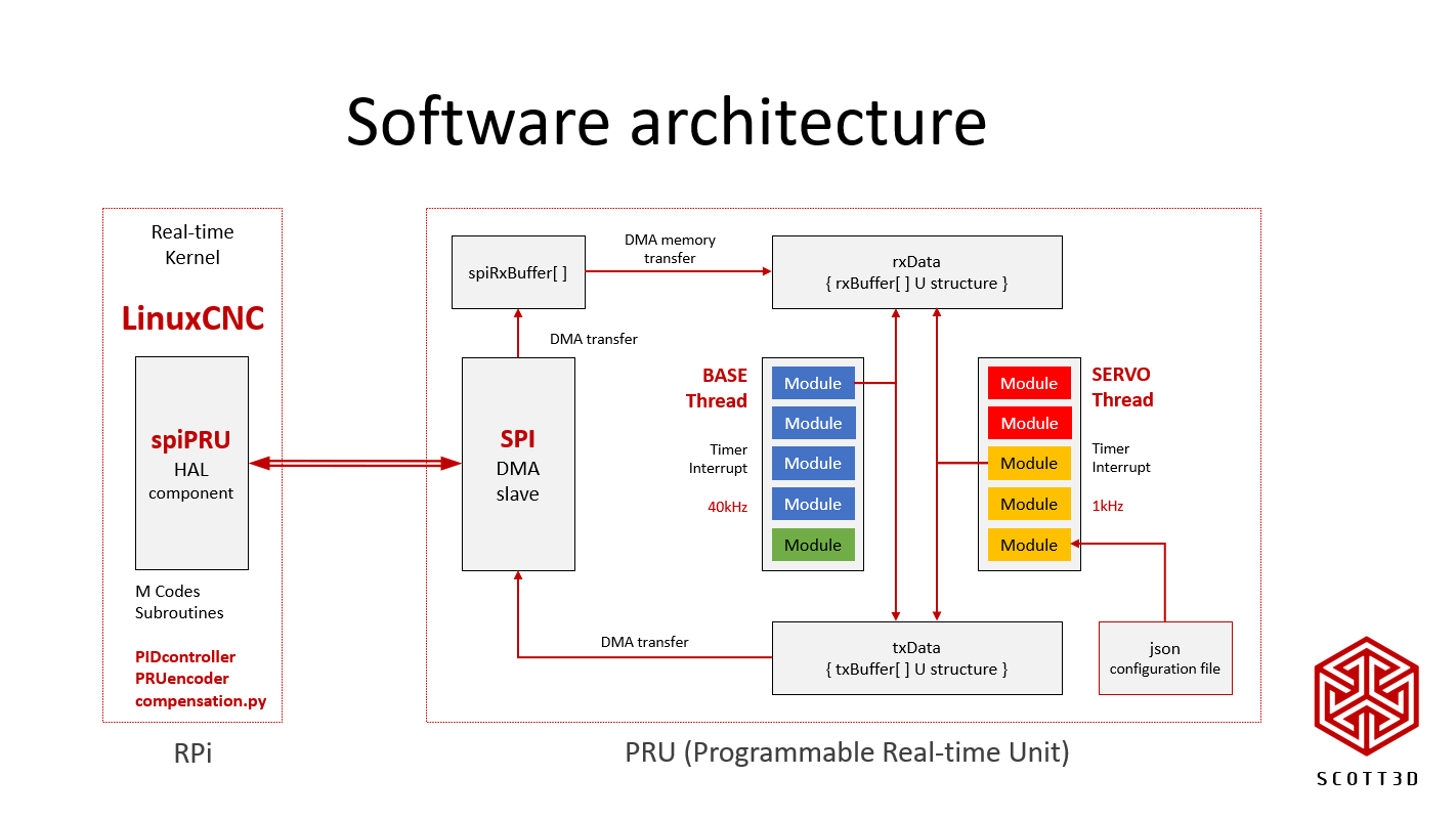

I really need to publish my new firmware for Smoothieboard clones, LPC1768 based boards. LinuxCNC running on a RPi talking directly to the PRU (the LPC1768 based board - Smoothieboard, Bigtreetech SKR etc) over the SPI interface, which handles real-time step generation, IO and heater control. Full closed loop functionality is also working.
Gives all the functionality needed for a CNC machine (engraver, router, printer) using readily available and mass produced (cheap) hardware.
I'm using a poor mans BLTouch as I have not had a great result with the cheaper versions of the BLTouch.
I'll share the subroutines for map generation over the weekend.
BR
Scott

Well I'm not sure i understand : Did you mean you have write some firmware for use a smoothieboard with linuxcnc ??? If this is that i'm really interested because these card software are not really great and from long time i have some regret to not use linuxcnc for my first retrofit...
I ask for Bltouch mostly for know how it is wired and configured with Lcnc ?
Closed loop with smoothieboard or equivalent ???
Br

Yes, correct. A new firmware that allows a smoothieboard (or clone) to be used with LinuxCNC!
BLTouch is wired to the control board (PRU) and the IO and PWM (servo position) commands are sent over the SPI interface. Custom M Codes in LinuxCNC as well.
For closed loop control there is an Encoder module which gives position feedback to LinuxCNC.
BR
Scott
BR

Unfortunately the SPI cable needs to be as short as possible to ensure reliable communication. Current HAL real-time component runs the SPI at 6.25MHz. A slower frequency could be used but then you would need to run the LinuxCNC servo thread at a slower rate.

Is your code:
a. compiled with vsc
b. only running 1768
c. possible to run TMC2209
Anyhow a very interesting aproach for small machines.
Mike
