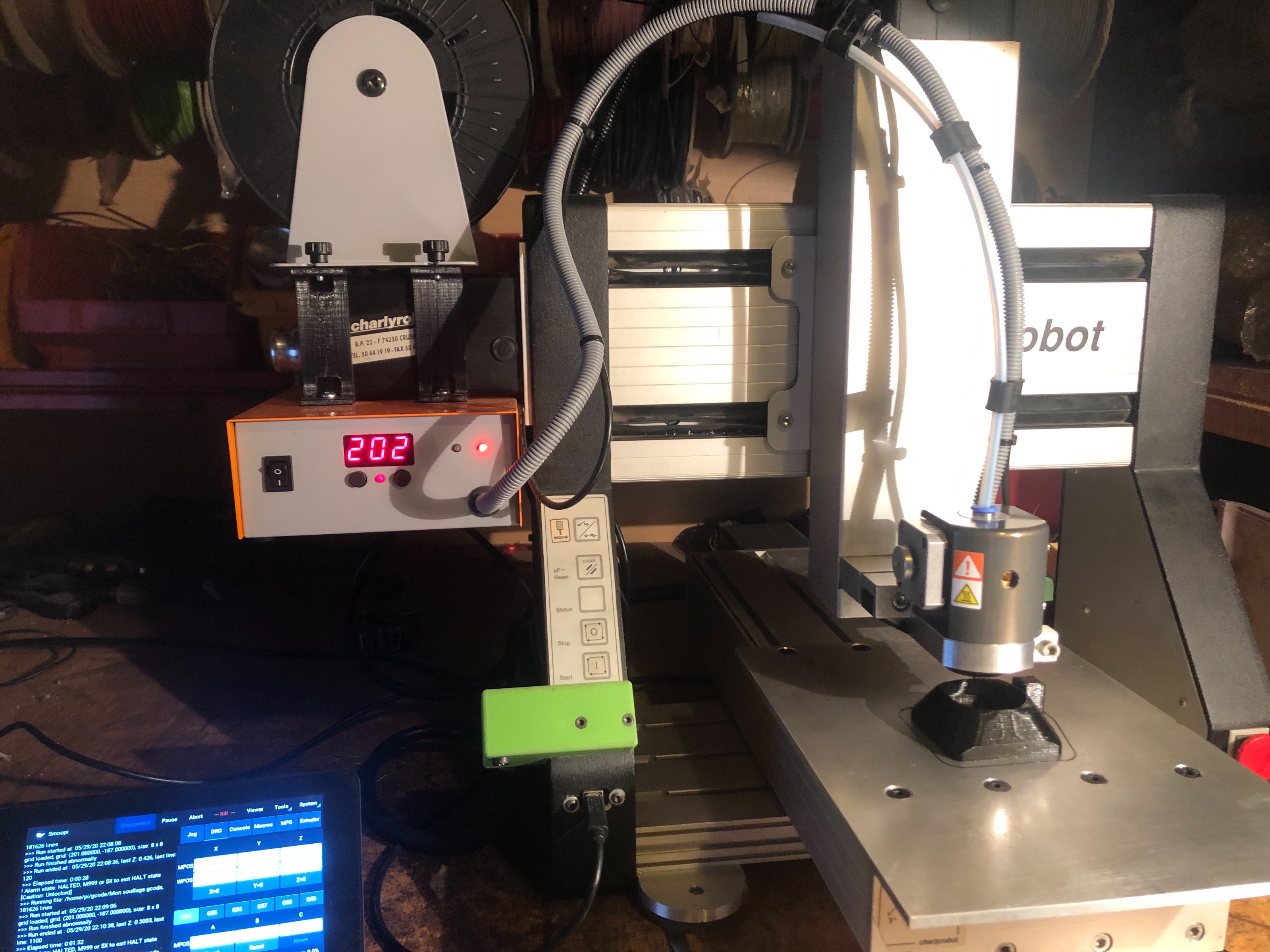

29 May 2020 23:55 - 29 May 2020 23:57 #169363
by alkabal
Replied by alkabal on topic New compensation component for engraving and 3D Printing
Hi
OFF COURSE !!
I not really like soompi and have some issue with smoothie config.
I like to add something for autostart after temperature is reached, if this is possible using the led from controller, but this need to be checked only one time at startup (impossible with smoothieware)
I like to have a storable offset for bltouch to nozzle like marlin for full use bltouch for Z probe and to be able to adjust the offset only when really needed with a simple command; i'm not sure how to do this with Lcnc for the moment but i think this is something possible.
The problem is i can't test all the stuff because :
- i haven't a heated bed
- i use a standalone temperature controller
+ SPI wire length can be a problem.
My setup is a isel ep1090 mill with 4 axis sharing config with 3D printer using a genuine smoothieboard V1 4xc.
4x DM556
1x Stepcraft standalone extruder
1x Bltouch (+ touch plate for cnc so i need the possibility to use signal inverted or normal or separating the stuff)
5x physical button on the machine
1x planned filament detector with encoder wheel
4x relay
2x pwm (fan+Bltouch)
So this is for me mostly a mill conversion to really wanted Linuxcnc on this machine, without changing wire and hardware this is very very cool project !
At home have Rpi3 + official screen (at first for smoopi only) and Rpi4 + 13" touchscreen for the Linuxcnc Mesa 7i96 lathe.
Attached my config file if this can help for you to check prerequisite.
For my use i need (but can be changed off course according to your fw and config) :
-M104 and M3 activating the same relay (M5 and M81 for stopping)
-M280 for Bltouch
-M375 for loading compensation component (i like to start config without compensation)
-G32 for create Bed compensation
-M106/M107 for fan
-M7/M8/M9 for flood/mist or light
-M0 for pause after activating the main relay (wanted to be replaced by leh checking for temp is reached)
Br
Aurelien
Ps : really if ethernet is something possible later this is the best option imo for allow to use Rpi outside of the machine.
OFF COURSE !!
4x DM556
4x relay
-M280 for Bltouch
-M106/M107 for fan
Br
Aurelien
Last edit: 29 May 2020 23:57 by alkabal.
- alkabal
- Posts: 476
- Thank you received: 52
29 May 2020 23:59 #169365
by alkabal
Today printing
- scotta
- Posts: 959
- Thank you received: 489
30 May 2020 01:30 #169375
by scotta
Replied by scotta on topic New compensation component for engraving and 3D Printing
Interesting setup! LinuxCNC is a great platform. I use the tool table and "tool changing" between the extruder and probe.
I'm just doing a new setup based on Raspberry Pi OS Buster and the buildbot deb. Previous installs have been with Arch Linux. Hopefully now that the arm builds are back in the Buildbot getting up and running will be a lot easier.
BR
Scott
BR
Scott
