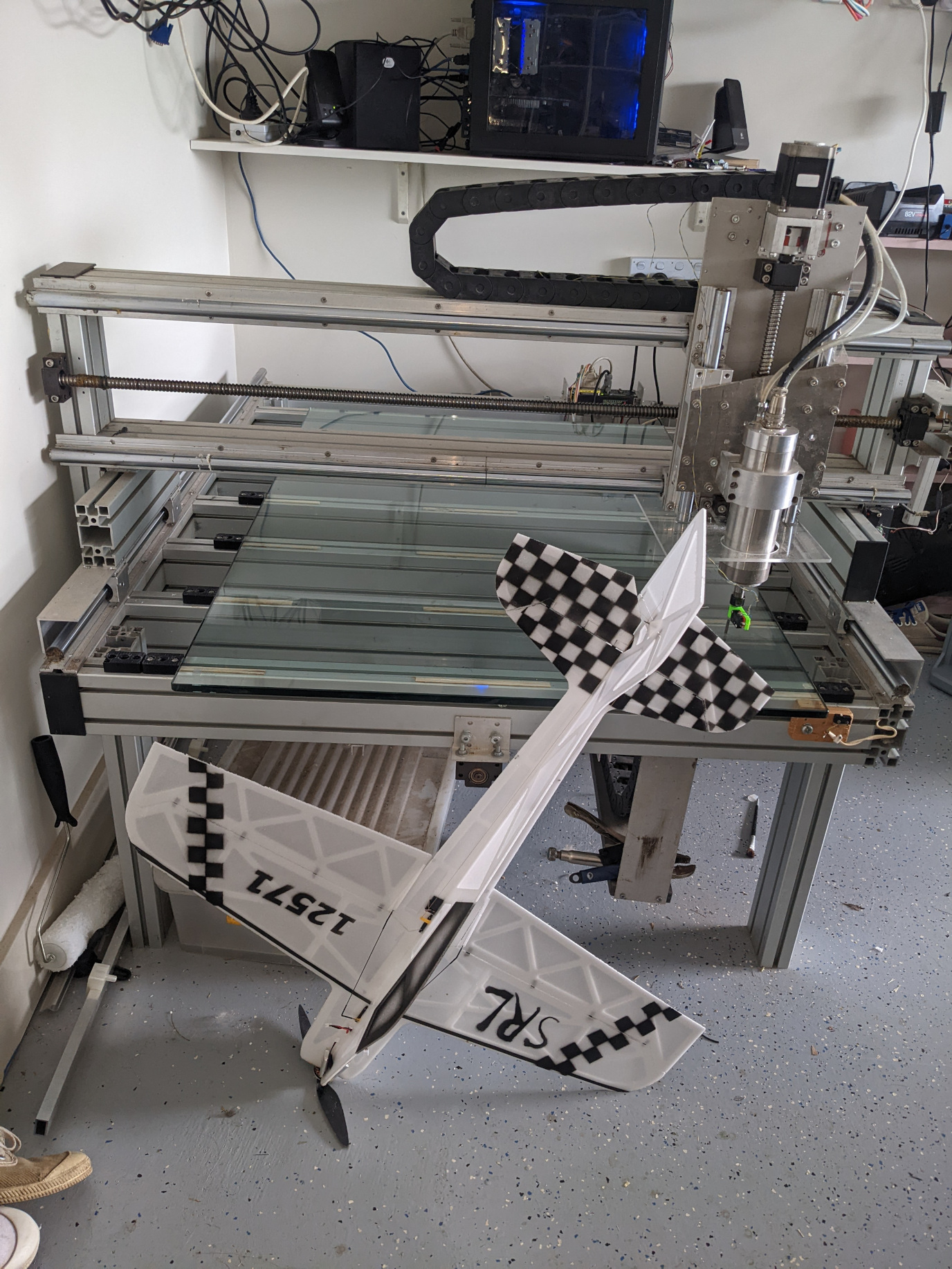

27 Jan 2022 06:22 - 27 Jan 2022 06:29 #233255
by SrLange61
Replied by SrLange61 on topic New compensation component for engraving and 3D Printing
Hi
I'm keen to get this going on my CNC to cut and mill Depron. Glass is .3mm up in a area. Its a standard 64bit linuxCNC DEB install. First it needed Scipy so I did a "sudo apt-get install python-scipy" ?
Now this -
Debug file information:Note: Using POSIX realtime./custom.hal:4: python exited without becoming ready1306Stopping realtime threadsUnloading hal componentsNote: Using POSIX realtime
Any ideas?
srl
Now this -
Any ideas?
srl

30 Jan 2022 04:52 #233514
by SrLange61
My compensation.py file was formated wrong, I did a cut and paste instead of a download.
It now loads up fine.
I now need to work out the comands as my hal file uses joint's.
srl
srl

01 Feb 2022 09:01 #233693
by SrLange61
I'm having a problem with the hal lines. I have a standard Stepconfig set-up.
With two "net xpos-cmd" lines it has a config error.
Commenting out the the first- "#net xpos-cmd joint.0.motor-pos-cmd => stepgen.0.position-cmd"
the program runs but I get a "joint 0 following error" when I move the tool.
Any ideas ?
Any ideas ?
