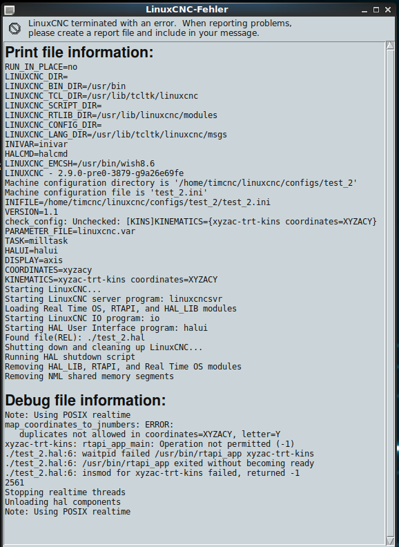

I want to use xyzac-trt-kins in my XYYZAC setup but i get the following error message. Any ideas, whats´s the issue here?

The posted screenshot shows:
> LINUXCNC - 2.9.0-pre0-3879-g9a26e69fe
That indicates it is at commit 9a26e69fe
which is dated May 11, 2021
Ref: github.com/LinuxCNC/linuxcnc/commit/9a26e69fe
The facility for xyzac-trt-kins to support duplicate
axis letters:
Ref: github.com/LinuxCNC/linuxcnc/blob/master...xyzac-trt-kins.c#L26
was added to the master branch at commit 135b0ce522 on Jun 19 2021
Ref: github.com/LinuxCNC/linuxcnc/commit/135b0ce522
So your version is too old -- update to current master branch
axis letters:

Thank you so much. So, a simple update via the package manager should fix the issue?
- Thank you received: 4654
09 Jun 2022 23:58 #244832
Replied by andypugh on topic XYZZBC-trt-kins module
If that is how you got LinuxCNC in the first place, yes. But it has to be 2.9, ie the development version, and that comes from the buildbot not the main repository.Thank you so much. So, a simple update via the package manager should fix the issue?
