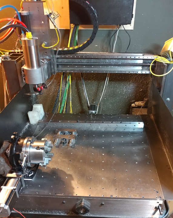

I am still reading through this thread and I read a lot on AC and BC configurations is it possible to use this "switchkins branch" on an AB configured machine. I have a rotary table for the A axis and the spindle rotates in the B axis. I have attached a picture for clarity.
I guess I am confused as to how I would go about handling the changing offsets between A and B. I hope I am over thinking it.
