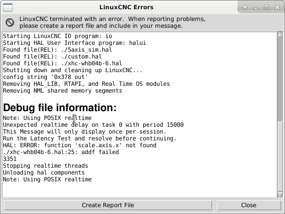

18 Feb 2021 12:37 #199246
by marq_torque
Replied by marq_torque on topic Can i Jog part program using MPG ?
Attached here my hal files
I have commented 24to36 lines, 82to102 lines

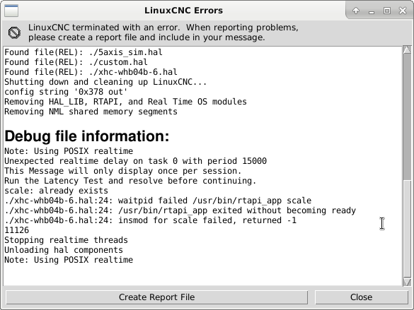

18 Feb 2021 12:41 - 18 Feb 2021 13:22 #199247
by marq_torque
Exact message when i used xhc hal without comments

- Thank you received: 4654
18 Feb 2021 23:13 #199356
Replied by andypugh on topic Can i Jog part program using MPG ?
"Scale" already exists.
You need to loadrt scale in only one place, with the number that you need.
So remove the "loadrt scale" from xhc-whb04b-6.hal, and have
"loadrt scale count=2" in the new (earlier in the sequence) HAL file.
Then use scale.1 in the new stuff, and leave scale.0 in the xhc HAL file.
The following user(s) said Thank You: marq_torque

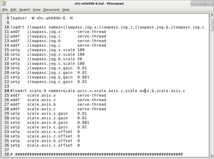

19 Feb 2021 06:43 - 19 Feb 2021 06:44 #199374
by marq_torque
May be i'm missing something ?

- Posts: 4818
- Thank you received: 2176
19 Feb 2021 07:57 #199376
Replied by Aciera on topic Can i Jog part program using MPG ?
You need to uncomment line 24.
