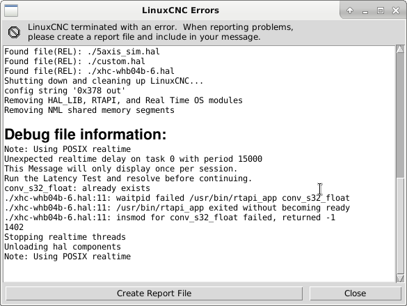

What is the adaptive feed going to be controlled by? In your HAL snippets it comes from "jog-counts" but I don't see anything driving that signal.
Do you really need lowpass and ddt?
Is this a code snippet that you borrowed from somewhere and are trying to use without really understanding what it does? It seems excessively complex.

You need to uncomment line 24.

This is all in the docs but:
You can only loadrt each component once. This needs to be done in a HAL file that is interpreted before any other HAL file that tries to use the component, or inside the same HAL file and before the component is addf-ed or net-ed.
The exception to this is using TWOPASS, but in that case each instance of the component has to be be given a name with the names= directive in the loadrt.
But first answer the question about where jog-counts comes from. Otherwise this is all a waste of time.

Do you have the MPG set up to change the value on the motion.adaptive-feed HAL pin?
Have you studied the HAL documentation enough to know what I am describing?
