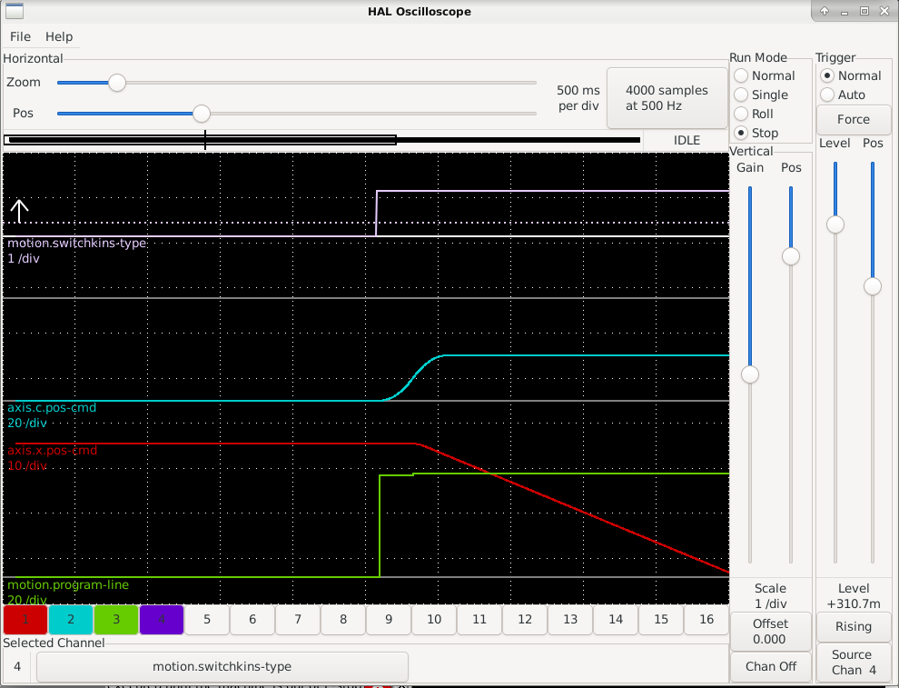

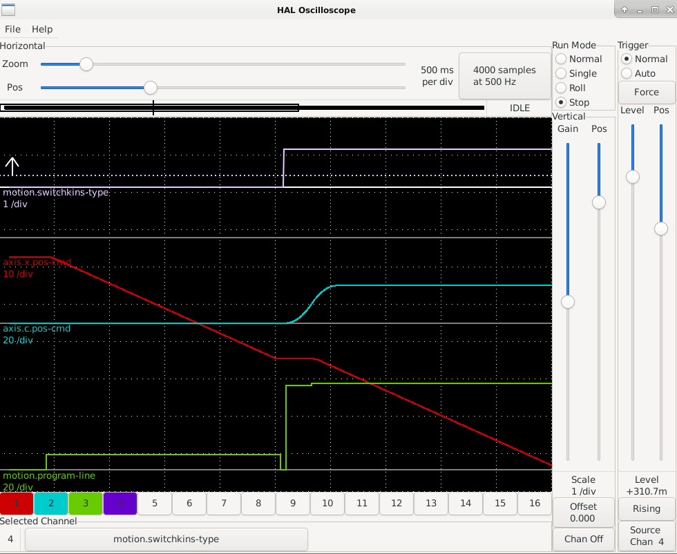

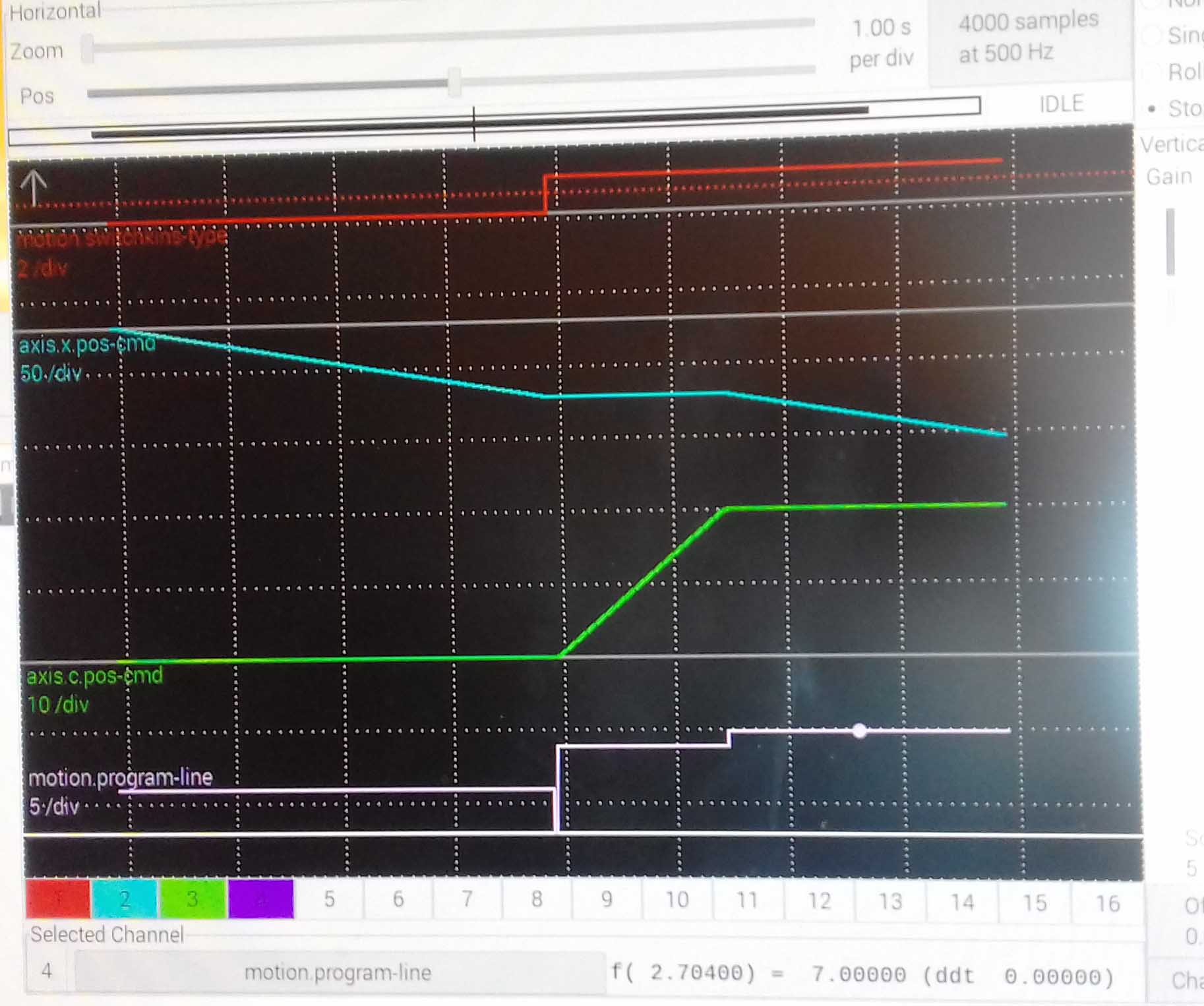

We have tried to reproduce the problem in the stest simulation - without success. On the Simulation, the first C axis move after the switch is generated correctly, whereas with the same ini file settings on the actual lathe, it is always incorrect.
The problem seems to be related to what occurs as a result of the M66 command after the M68 command. What we have noticed is that there is
a repeatable difference in the motion.program_line log.
The ngc file is as follows

In the simulation, the log is line 3 --> 0 --> line6 (See plot of motion.program-line below)
Whereas in the real machine, the log is line 3 --> line 4 --> 0 --> line6 (See plot below of motion.program-line below)
We are not sufficiently clued as to what the significance of this is - but maybe it may aid those endeavouring to assist us with this issue to home in on the problem

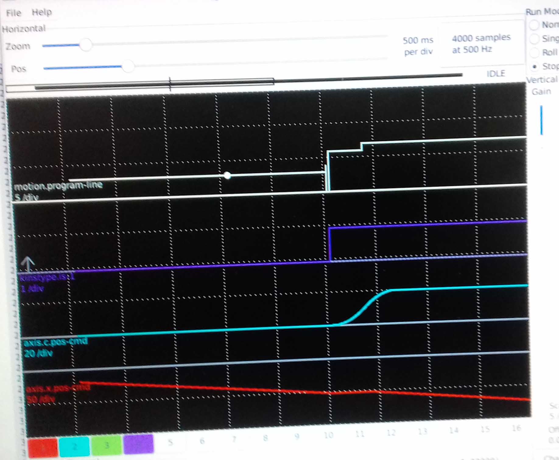

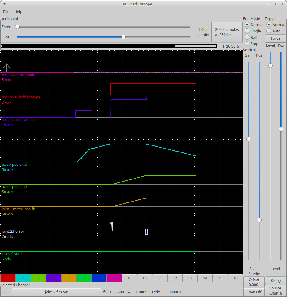

We have performed the tests as requested. Results as follows:
(1) Playing with sequence of addf caxis.0 servo-thread makes no difference
(2) The outputs from the debug prints are as follows:
Dwell_______ 0.000
aBEFORE SWITCH OK j2=0.0
bBEFORE SWITCH OK j2=0.0
AFTER SWITCH OK j2=0.0
(3) linuxcnc_info for hardware is attached
Regardless of whatever changes we make to settings related to accelerations and velocities in the ini file, the problem remains unchanged with the problem line : (ie vel and ini_maxvel set tro zero)
EMC_TRAJ_LINEAR_MOVE -- ( +220,+208, +0,-52.250000,0.0,0.0,0.0,0.0,20.0,0.0,0.0,0.0, +2,0.0,0.0,0.0, +0, -1,)
We have hence searched the source code to trace the path of code executed as a result of the M66 command.
This command will result in function 'flush_segments' being executed.With reference to the lines
if (canon.cartesian_move && !canon.angular_move) {
if (vel > canon.linearFeedRate) {
vel = canon.linearFeedRate;
} else if (!canon.cartesian_move && canon.angular_move) {
if (vel > canon.angularFeedRate) {
vel = canon.angularFeedRate;
} else if (canon.cartesian_move && canon.angular_move) {
the second case is applicable for our problem move (ie an angular move only). If for some reason, the value of canon.angularFeedRate is zero, this would explain why the values of vel and ini_maxvel are zero. Could this be the source of the problem?
Is there a pin by which we can gain further insight into these values?

Attached is a new sim config (stest2) that adopts
caxis.comp (renamed as stest2_caxis.comp) and implements
joint2 (c coordinate) using the in-tree sim_spindle
component configured with a velocity-based pid.
Instead of making a test branch, all files are included
in the attached tar file so it can be tested with the
master branch (or any branch based on recent master).
(The stest2*.comp hal components must be
halcompiled/installed).
Example:
$ wget stest2.tar ;# use link for attached file
$ tar xf stest2.tar ;# extract contents
$ cd stest2
$ # Note: sudo reqd for deb installs (not needed if RIP)
$ sudo halcompile --install stest2.comp
$ sudo halcompile --install stest2_caxis.comp
$ linuxcnc stest2.ini ;# run the stest2 sim config
In axis gui:
F1 # Estop off
F2 # Machine-on
Ctrl-Home # HomeAll
R # Run OPEN_FILE=stest2_square.ngc
A definitive test for checking the compatibility of a
machine's hal components/connections that manage
joint.N.motor-pos-fb values is to 'short circuit' the
joint's motor-pos-cmd to its motor-pos-fb. Such a test
will disable actual joint motion but ensure LinuxCNC's
expectations that joint.N.motor-pos-cmd and
joint.N.motor-pos-fb are *always* the same (to within
the limits enforced by inifile settings for
[JOINT_N]MIN_FERROR and [JOINT_N]FERROR).
The tar file includes an additional inifile
(stest2_shortcircuit.ini) that demonstrates this test
by adding a [HAL]HALFILE=shortcircuit.hal that removes
(unlinkp) prior joint.2.motor-pos-cmd, motor-pos-fb
connections and then makes the short circuit
connections.
When a configuration works as expected with
shortcircuit connections but fails with halfile
specified connections, something unexpected is
happening.
A similar test on real hardware would be useful.
One method is to copy the realmachine inifile to a
new 'test.ini' file and add an appropriate
[HAL]HALFILE=shortcircuit.hal.
The setting in CNC_Lathe.ini (zip file from post
223654) for [JOINT_2]MIN_FERROR=1000,FERROR=1000 are so
big they will likely mask unexpected following errors.
Large ferror settings may be useful while tuning but
should be set to realistic values for operation. Using
appropriate inifile ferror limits and plotting the
joint.2.f-error could be instructive.
connections.
happening.
