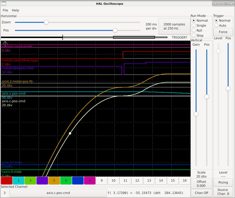

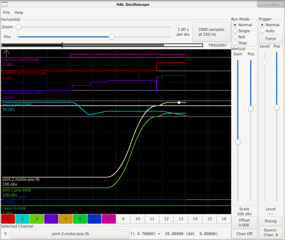

02 Nov 2021 16:45 #225013 by NoJo
We have got the new sim working and have run the tests on the target hardware with the short circuit as requested. The short circuit makes no difference to the problem - ref the plots attached. The second plot is just zoomed in - please ignore the plot on joint.2.motion-pos-fb and axis.c.pos-cmd prior to the switch. I suspect these are happening as the homing does not complete due to the short circuit. However, the shape of the command after the swithkins switch clearly shows that the problem is still there irrespective of the short circuit.
With reference to the code - could I please request an update to the stest branch (as I am not able to rebuild the code myself at this stage). From my analysis of the debug prints, it seems the problem is originating in the call to getStraightVelocity from flush_segments. It would be useful to have the values printed in function getStraightVelocity if the value of debug_velacc is non-zero. So a build where
static int debug_velacc = 1;
would be appreciated.
