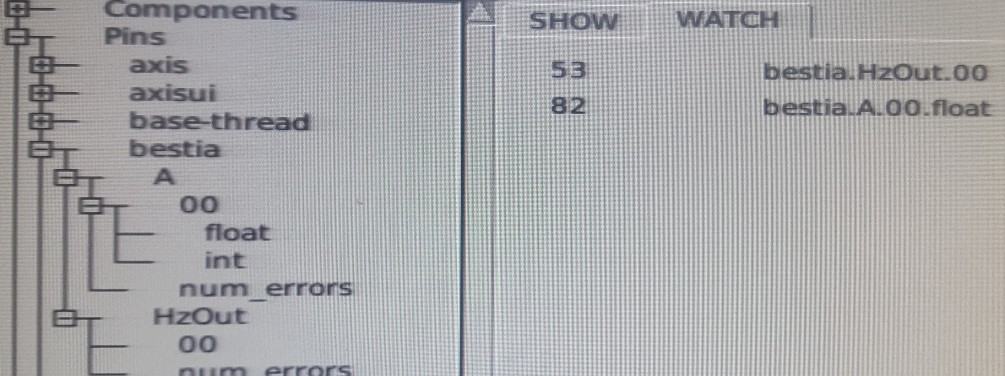

Hi
I am trying to switch from ClassicLadder to MB2HAL.
I have a VFD configuration in CL that works (but sometimes it issues an error)
I am doing a trial configuration in MB2HAL (in CL -ModBUS department the value changes well).
Her task:
Write the value 5.3A to the register H05 and Read the register H05 to check if the changes have occurred.
The VFD is the N700E - linyxcnc 2.7.15
the set current in H05 (1541Dec = 0605Hex) is 8.2A = 82Dec
and such is read by MB2HAL
In my opinion, the frame for shipping should be like this (and you can see that it is wrong)
01 10 0605 0001 02 0035 0012 where 0035 is the Hex record of the value 53
As you can see it doesn't work
Communication is because the value reads correctly.
www.forum.linuxcnc.org/10-advanced-confi...nuxcnc-2-7-14#229642
I helped myself with this github.com/swepeter/PrintNC/tree/11a4edd...eea4399d0a321ed9a344

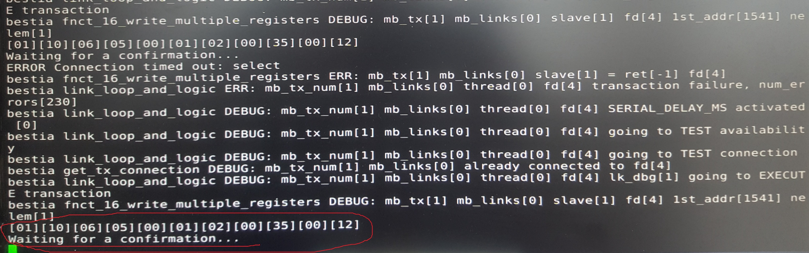

I guess I got to the bottom of the problem.
I connected the logic analyzer:
-Mb2HAL write to multiple registers even though I only send 1 register in other words use command 16.
-Clasiccladder, although it cannot be selected whether we will use code 6 (writing a single register) or code 16 (writing multiple registers), when the user sends only one register from the machine, the command is selected as 06 and when many 16
Everything indicates that my VFD cannot interpret the command "write to many registers" (strange because I read somewhere that it can, but now I look at the datasheet and in the examples there is actually no 0x10 / 16, only examples with 0x06
Now the important question is HOW TO CHANGE MB2HAL to be able to use the code 0x06?

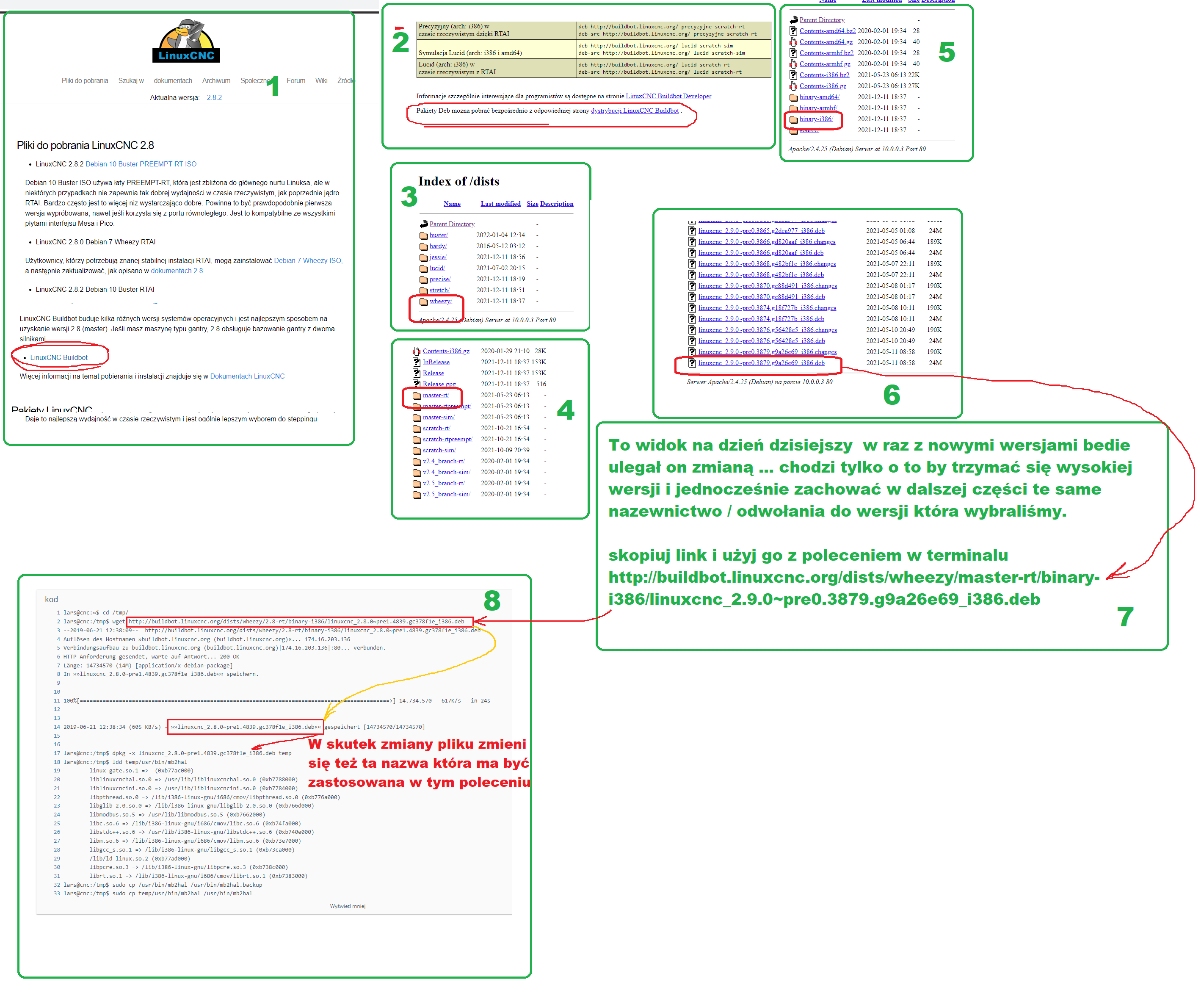

06 Jan 2022 10:14 #230931
by Adam Maszynotwór
Replied by Adam Maszynotwór on topic MB2HAL I can read but cannot change the registry. fnct_16_write
Thank you again for your interest
Yes, of course, I tried 06 but Linuxnc does not even turn on then, it only crashes an error right away, so you can't use PIN_NAMES instead of NELEMENTS.
This is generally strange because this problem was discovered many years ago and from around 2018-2019 there is information about patches where the last updates to 2.7.15 were made relatively recently.
Oddly enough, even the instruction for 2.8.2 does not provide function 06 until development 2.9, this function is in the instruction
I have been struggling with this topic for the next few days and we have a breakthrough
& pageNo = 1
I was able to update by pulling the MB2HAL file from version 2.9 and uploading it to my 2.7.15
PIN_NAMES and NELEMENTS work now, as well as writing to single register 06.

Some information for posterity in the appendices
I am at the stage of getting along with the inverter -It is strange that the communication errors that I encountered during attempts with ClassicLaddder have disappeared
cnc@192:~$ cd /tmp/
cnc@192:/tmp$ wget http://buildbot.linuxcnc.org/dists/wheezy/master-rt/binary-i386/linuxcnc_2.9.0~pre0.3879.g9a26e69_i386.deb
--2022-01-05 10:08:46-- http://buildbot.linuxcnc.org/dists/wheezy/master-rt/binary-i386/linuxcnc_2.9.0~pre0.3879.g9a26e69_i386.deb
Translacja buildbot.linuxcnc.org (buildbot.linuxcnc.org)... 75.166.176.174
Łączenie się z buildbot.linuxcnc.org (buildbot.linuxcnc.org)|75.166.176.174|:80... połączono.
Żądanie HTTP wysłano, oczekiwanie na odpowiedź... 200 OK
Długość: 25565922 (24M) [application/x-debian-package]
Zapis do: `linuxcnc_2.9.0~pre0.3879.g9a26e69_i386.deb'
100%[======================================>] 25.565.922 955K/s w 26s
2022-01-05 10:09:13 (953 KB/s) - zapisano `linuxcnc_2.9.0~pre0.3879.g9a26e69_i386.deb' [25565922/25565922]
cnc@192:/tmp$ dpkg -x linuxcnc_2.9.0~pre0.3879.g9a26e69_i386.deb temp
cnc@192:/tmp$ ldd temp/usr/bin/mb2hal
linux-gate.so.1 => (0xb773b000)
liblinuxcnchal.so.0 => /usr/lib/liblinuxcnchal.so.0 (0xb7718000)
liblinuxcncini.so.0 => /usr/lib/liblinuxcncini.so.0 (0xb7714000)
libpthread.so.0 => /lib/i386-linux-gnu/i686/cmov/libpthread.so.0 (0xb76fa000)
libglib-2.0.so.0 => /lib/i386-linux-gnu/libglib-2.0.so.0 (0xb75fd000)
libmodbus.so.5 => /usr/lib/libmodbus.so.5 (0xb75f2000)
libc.so.6 => /lib/i386-linux-gnu/i686/cmov/libc.so.6 (0xb748a000)
libstdc++.so.6 => /usr/lib/i386-linux-gnu/libstdc++.so.6 (0xb739e000)
libm.so.6 => /lib/i386-linux-gnu/i686/cmov/libm.so.6 (0xb7377000)
libgcc_s.so.1 => /lib/i386-linux-gnu/libgcc_s.so.1 (0xb735a000)
/lib/ld-linux.so.2 (0xb773c000)
libpcre.so.3 => /lib/i386-linux-gnu/libpcre.so.3 (0xb731c000)
librt.so.1 => /lib/i386-linux-gnu/i686/cmov/librt.so.1 (0xb7313000)
cnc@192:/tmp$ sudo cp /usr/bin/mb2hal /usr/bin/mb2hal.backup
[sudo] password for cnc:
cnc@192:/tmp$ sudo cp temp/usr/bin/mb2hal /usr/bin/mb2hal
cnc@192:/tmp$ Please Log in or Create an account to join the conversation.
