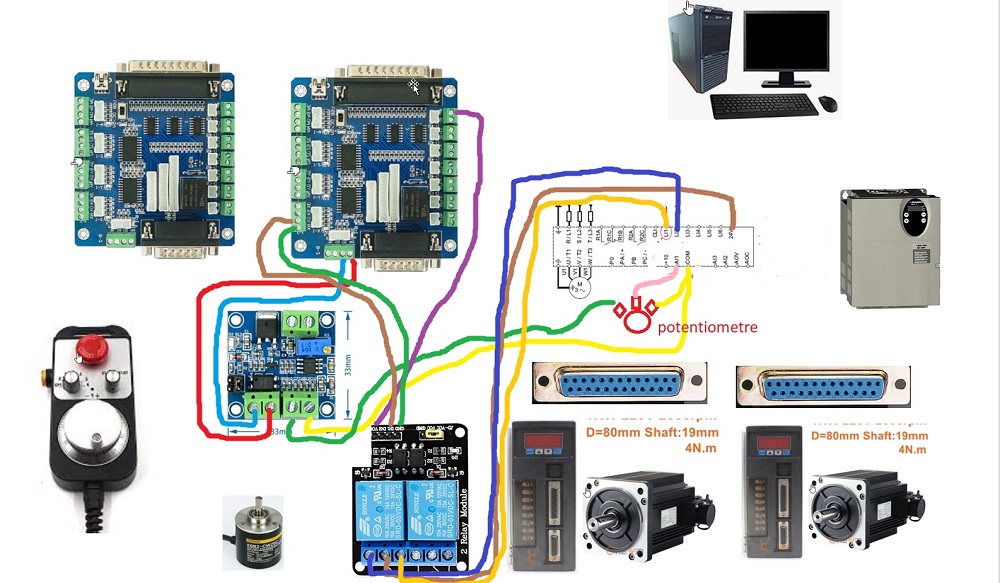

11 Mar 2022 09:52 #236925
Replied by andypugh on topic Need help with the orient component for spindle activation (M19)
Does the motor turn under normal conditions?
What are the various parallel port pins connected to?
- jpg
- Posts: 105
- Thank you received: 13
11 Mar 2022 16:46 - 11 Mar 2022 17:23 #236944
by jpg
Replied by jpg on topic Need help with the orient component for spindle activation (M19)
the motor turns normally (PWM), when I type M3/M4 S200 or other and stop (M5), I think only that it does not have the information to turn when I launch a M19 R45 or other; the most vexing for me, it is that the relay starts and stops when I turn the encoder (by hand, I did not connect it to the spindle, for now)
this is what I try to show on the video (at 2mn 11) sorry for the schema, I did it quickly
