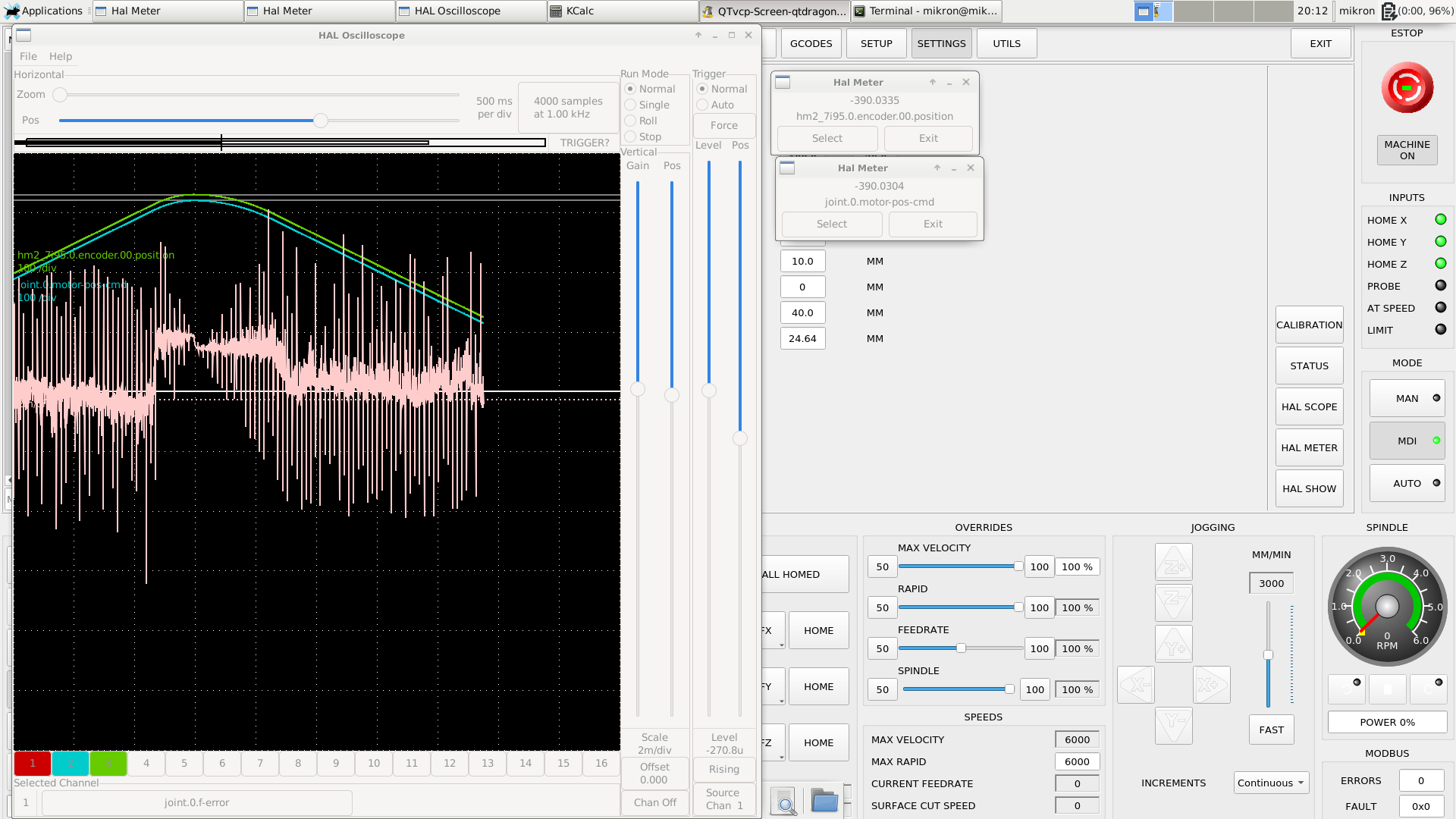

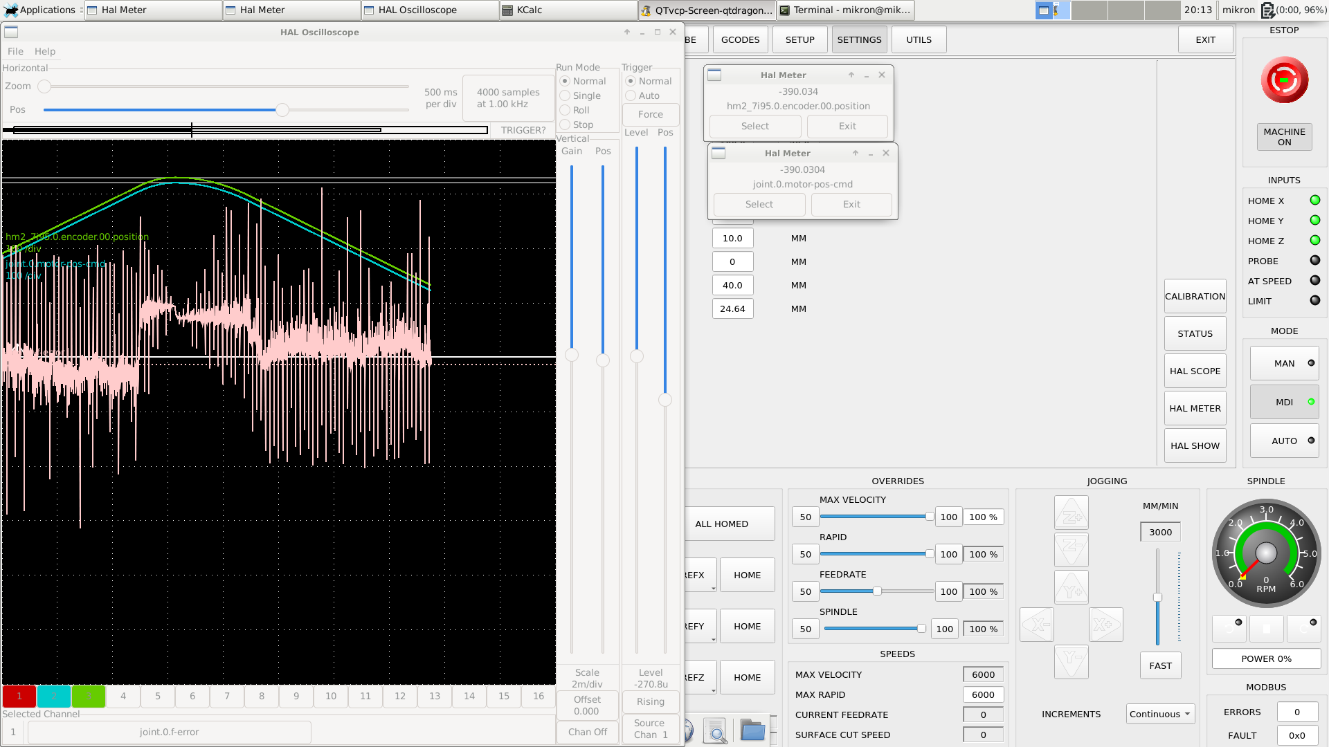

11 Apr 2022 18:18 #239952
by myval
Replied by myval on topic Another servo tuning
now I did 5 runs 0 to -390 and the results are attached.

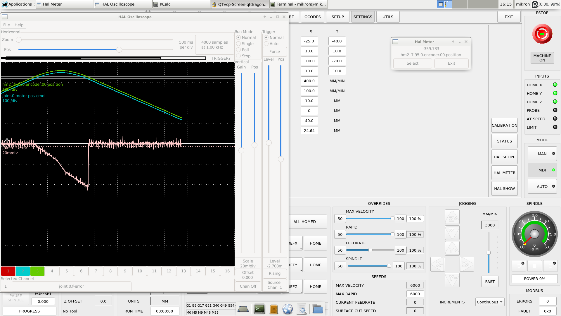

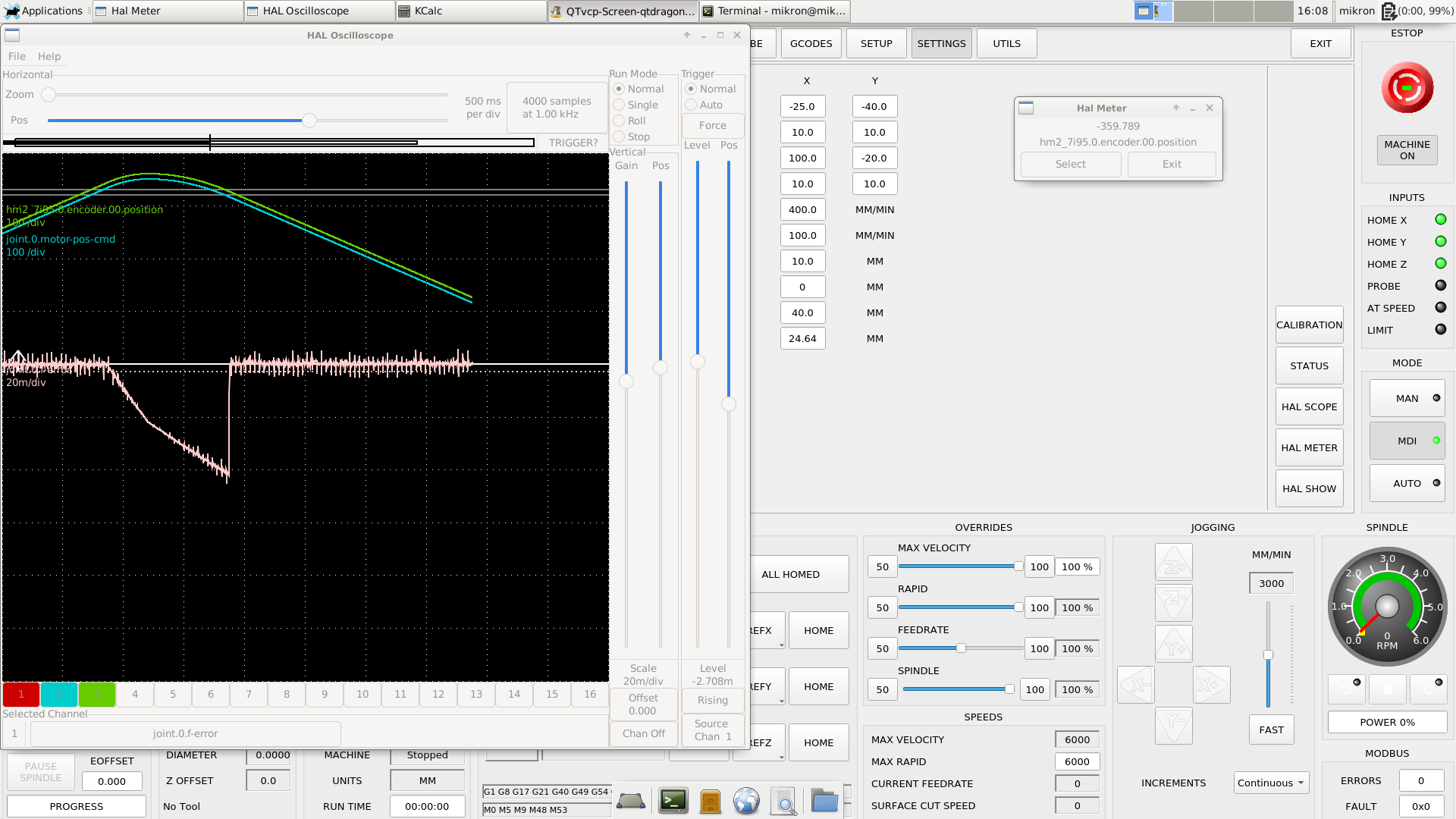

12 Apr 2022 14:50 #240049
by myval
I set it in position control without pid , motor-pos-cmd => stepgen.position-cmd
just get this massive ferror spike but it runs ok. Hits dial indicator within about 0.01 which is fairly decent I guess would only like to bump it up when I run highspeed grinder spindle on it but that is not current issue.
This acceleration and speed is as good as the machine can go, well can go slightly faster but I don't think there is a need for more speed.
So where do I take it from here?
Why is the ferror so spiky?
How to get rid of that massive spike at the start?
