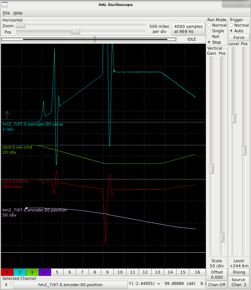

Hello community,
I am currently tuning my axis and ran into a strange behavior.
I am tuning my PID and used I/D/FF0/FF1/FF2=0 and started with the P value.
I increased the P value and could see the following behavior:
P=1 follow error = -5
P=2 follow error = -4.5
P=4 follow error = -3.3
P=6 follow error = -2.2
P=10 follow error = -1.8
P=15 follow error = -0.8
and finally
P=20 follow error = -0.22
When I arrived at P=20 the axis started to accelerate and deccelerate strongly.
I first thought that the encoders are giving strange feedback, but the position graph in the hal scope looks flawless.
and finally
Last edit: 04 May 2022 17:19 by chili023.

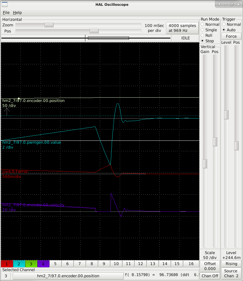

I checked the PID inputs and I realized that the encoder uses velocity not position.
I assumed velocity and position are linked by the first derivate, but the new screen shot shows, that position looks good but velocity goes to 0 when the strange behavior occures.
This seems to be the problem.
Can anybody tell me how this can happen?
Computing power?
I run my glas scales with Heidenhain EXE 612 and 10 fold interpolation.
so 4000 pulses per mm.
Computing power?
Last edit: 03 May 2022 14:46 by chili023.
- Thank you received: 4654
03 May 2022 15:27 #241921
Replied by andypugh on topic [SOLVED] strange PID behavior. Closed loop Servo drive system. EXE impedance
The step-changes in encoder.velocity are physically implausible. It is possible that the error in the position trace is just hard to see because of scaling.
It rather looks like the EXE box simply stopped sending pulses for a moment.
You can move the cursor around on the graph to look at the position and see if it did actually change when the velocity was showing as zero. However the linear increase in F-error at the time suggest not.
You could try graphing the A and B channels into the encoder (but be aware that at a 1ms sample rate this can be very misleading)

Hi Andy,
I did some further investigation. Indeed the position value stays constant for the time in question.
Am I correct assuming that even with 10 fold interpolation of the encoders the input frequency should not be a problem for my MESA card?
I ran my tests with 1000mm/min so 16.6 mm/s and 66.6 kHz input frequency to the encoder input.
I will run test with 5 fold and check if the powersupply is sufficient. I use very thin cables that are shielded, even for 5V. Maybe this leads to a reset of the EXE. I will report.

Hello. Good news. I found the problem.
First I took the glas scale out and cleaned it. It was a little dirty but nothing that would alarm me.
After cleaning I installed the scale and the error still excisted.
The solution was that the EXE 612 have 2 settings for the output impedance.
A High and a Low setting. The X axis was on high.
When I switch it to low the error was gone.
I could tune all my axis and I can start milling now.
I attached the EXE manual with all the needed information.
Thanks and greetings
