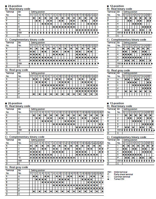

Thanks for the information. I will eventually be getting into my console to look at the selector switch wiring. I will replace them with 5 bit encoders if necessary.

11 Jul 2022 19:24 #247099
by gernoff
Replied by gernoff on topic Deckel FP5 Gearbox Comp
- Niko
- Posts: 132
- Thank you received: 5
12 Jul 2022 06:25 #247118
by Niko
Replied by Niko on topic Deckel FP5 Gearbox Comp
That should do it . Even if it's gray coded you can still get it going . There's a debug pin that outputs the decoded speed . What I usually do is write down a table with what it decoded and where the switch points at . After that it can be modified in the component itself .
Only thing I'm not sure are those logic elements . There's probably some control signals going there . Might need some reverse engineering .
