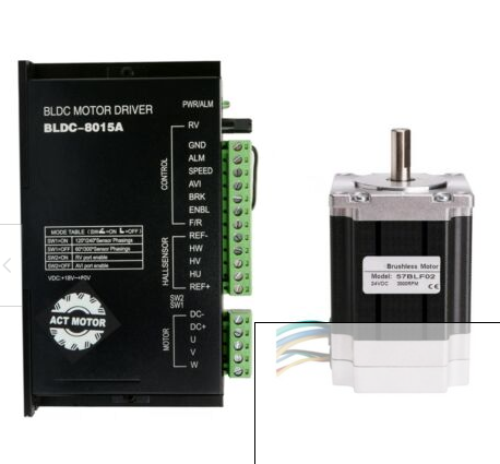

I have this driver with motor:
I can control the speed with the potentiometer on the driver, unfortunately the adjustment is very difficult with it. How can I control the speed with my 7i76e if I already use all 5 axes? A very small speed is enough for me since this is the motor for my Geneva wheel.
Keyword PWM, but with which pin could this go? maybe an analog output .....
or am I on the wrong track there?
30 Oct 2022 12:37 #255466 by andypugh
Do you know the specification of the PWM signal required? (The image is too small to read it, if it is there)
You might be able to set a constant speed with the potentiometer and just enable / disable the drive frim LinuxCNC.

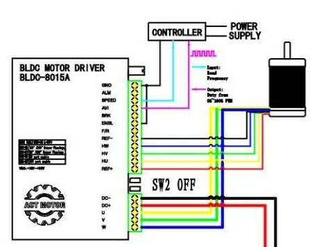

30 Oct 2022 13:13 #255472 by mgm
Yes currently I regulate the speed with the potentiometer on the driver, but this is, in my opinion, not fine enough for a low speed.
The on and off I do with a relay on the enable.
I still have this description:
=15pxSpeed regulation choice(RV ; AVI)
1. Setup speed by potentiometer (RV).The dipswitch SW2 must be ON status to enable this function.
CW rotate the potentiometer will increase speed. CCW- speed down.
2. Setup speed by analog input (AVI). The dipswitch SW2 must be OFF status to enable this
function.。AVI terminal accept 0~5V voltage or PWM signal from controller。AVI terminal with input
resistance of 100K,current consumption≤5mA。
Reference table
S W 2 Command to
Speed adjust Comman Current
O N RV CW—speed up,CCW—speed down - -
O F F AVI 0~5V analog input 0~5V volage ≤5mA
O F F AVI PWM 1KHz duty cycle -
Only one of above two modes can be used to adjust speed (another mode shall be enabled).
Once AVI terminal applied, (RV) potentiometer shall be CCW turned to Min. position。PWM signal are 5V TTL leve
