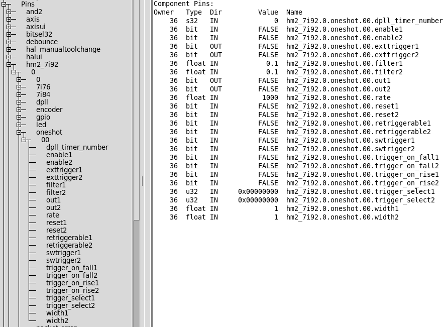

10 Dec 2022 10:21 - 10 Dec 2022 10:25 #259069
by roland
Replied by roland on topic hostmot2 oneshot bitfile help
I have flashed the 7i92.
mesaflash shows the oneshot pins:
I added the oneshot in hal:
But LinuxCNC does not create the oneshop pins
I'm on latest buildbot master LINUXCNC - 2.10.0-pre0-272-g10db23f49
Any ideas?

13 33 IOPort MuxedQCount 1 MuxQ-IDX (In)I added the oneshot in hal:
loadrt hm2_eth board_ip="10.10.10.10" config=" num_oneshots=1 num_encoders=4 num_rcpwmgens=1 num_stepgens=6 sserial_port_0=2120xx"But LinuxCNC does not create the oneshop pins

Any ideas?

what does mesaflash --readhmid show?

mesaflash --readhmid output see at the beginning of the previous post
Output seem okay for me

Look like there's a bug in the command line parsing
Try without the num_oneshots stanza in the command line
