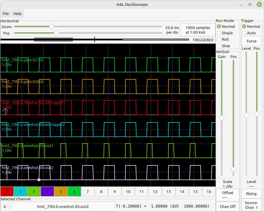

OK so a 7I96 (Xilinx) works as expected:
This first plot shows both oneshots being triggered by a 50 Hz square wave
fed into the 7I96's encoder A/B pins. The GPIO bits are the unfiltered equivalents.
oneshot 1 is set for 5 ms and oneshot2 is set for 10 ms. filter is 100usec:
This plot shows the same arrangement except the trigger is a 150 usec pulse
so not reliably displayable by halscope (but the oneshots are triggered)::
Do you want me to try building a 7I92 oneshot test bitfile?

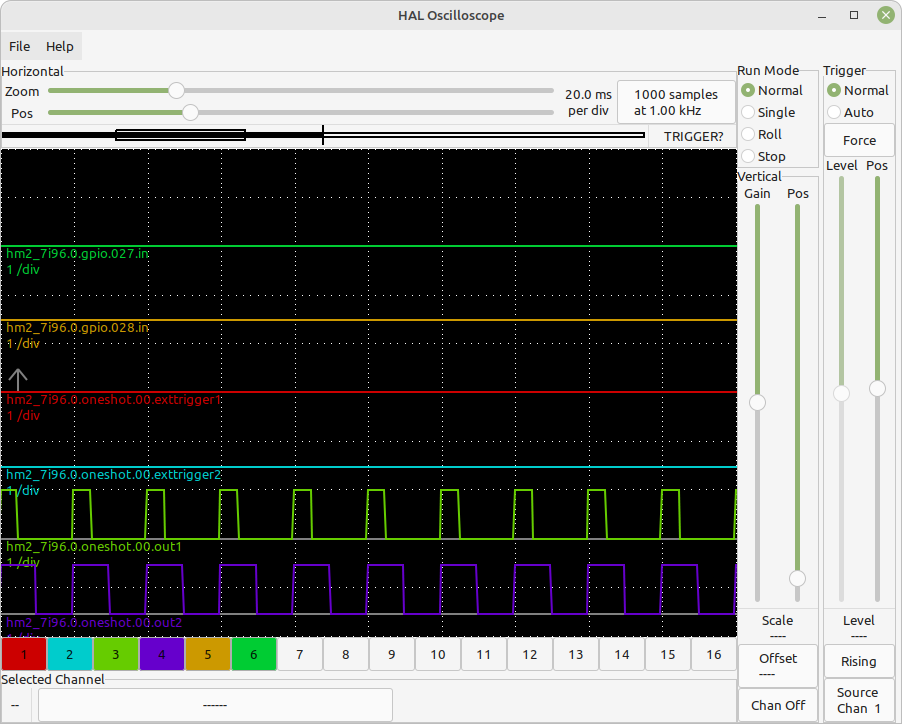

OK this works for me:
This test uses oneshot channel 2 as a 50 Hz 1 ms pulse generator,
triggering oneshot channe1 (set for 3 ms) via the external trigger input.
(loopback from pin 12 to pin 16 on the 7I92 DB25)

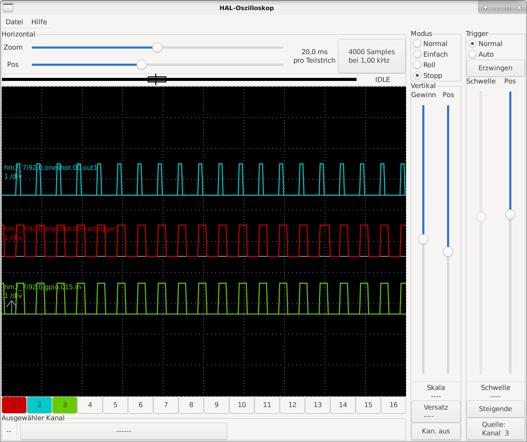

16 Dec 2022 07:30 #259612
by roland
Replied by roland on topic hostmot2 oneshot bitfile help

16 Dec 2022 16:10 #259648
by roland
I use your firmware.
Today I tested with a 5i25 and an other, older 7i76. It works perfectly with it.
Then I tested it again with the 7i92. For this I created a minimal setup. All disturbing devices (servo-drives, vfd...) were switched off. But with the 7i92 it does not work properly. I also give it up.

16 Dec 2022 16:33 #259652
Replied by PCW on topic hostmot2 oneshot bitfile help
Sorry for the rant and sorry for the issue. I think its fixed...
My tests ran perfectly because I was using perfect signals...
As soon as I introduced some noise, I could duplicate your issue.
The issue was a metastable on the external input sampling
The following user(s) said Thank You: tommylight, roland
