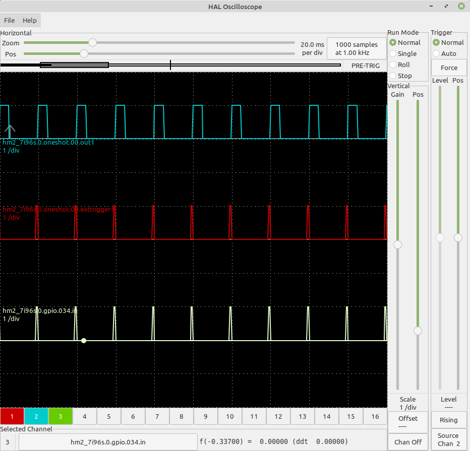

14 Dec 2022 18:31 #259484
by roland
Replied by roland on topic hostmot2 oneshot bitfile help
I have created the bitfile again with the latest sources. Same result.
Currently the signal comes from an optocoupler.
I use the encoder input on the 7i76 sigle ended. I checked the signal with the oscilloscope. The signal is not clean as expected.
With a short shielded cable the result was a little better. I think it is due to the electrical noise in the cabinet.
With a differential signal it would probably work reliably.
I have to find a way to get a differential signal from my laser light barrier.

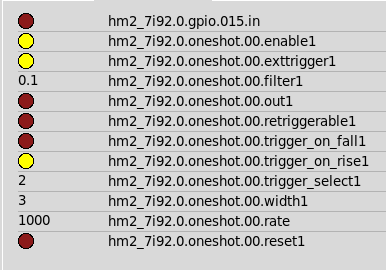

- Posts: 18075
- Thank you received: 5314
14 Dec 2022 18:52 #259488
Replied by PCW on topic hostmot2 oneshot bitfile help
The input digital filter should deal with most noise issues unless the are really major,
and in that casem I would expect that to show up in the unfiltered (GPIO) input as random noise pulses.
(The input filterishould normally be set to about 1/2 the expected minimum input pulse width)
Did you reload the FPGA after updating it?

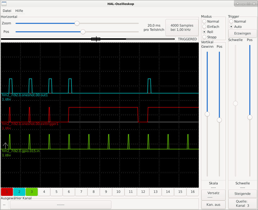

- roland
- Posts: 140
- Thank you received: 64
14 Dec 2022 19:42 #259489
by roland
FPGA is reloaded.
yes, right. The signal at the gpio is clean. So the noise should not be the big problem.
Now i connected the signal from the optocoupler together to GPIO 15 and 16.
Both signals (exttrigger1 and exttrigger2) are faulty. The two signals are not equal
- Posts: 18075
14 Dec 2022 20:23 - 14 Dec 2022 20:23 #259495
The reason I asked about reloading is that is the exact issue
with the older code (external input filtering was faulty)
I will see if I can duplicate this on Xilinx (I tested with a 7I96S = Efinix chip)
