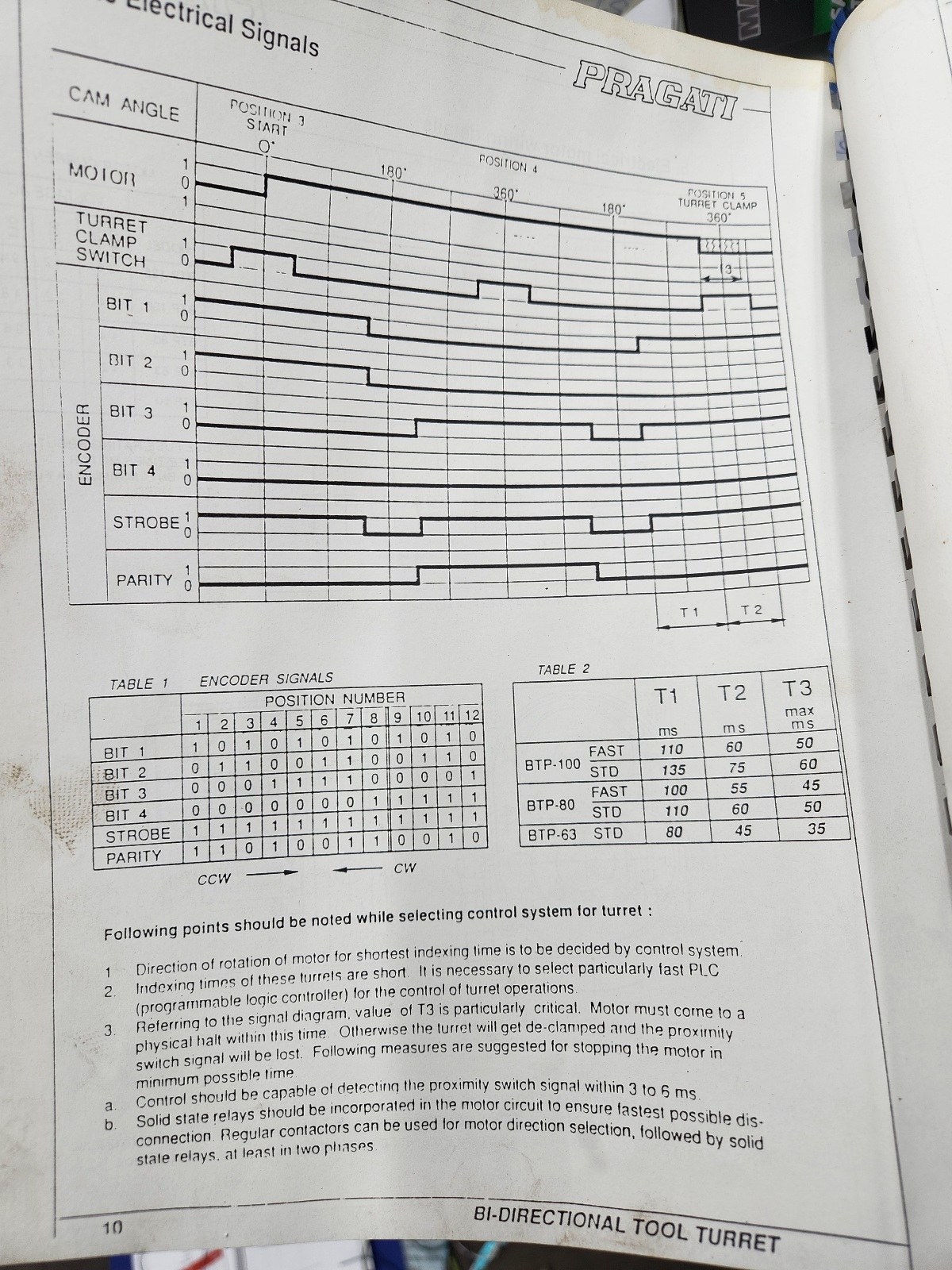

I'm at the point in my retrofit where the last 2 big things I would like to wrap up are the spindle winding selection and the tool changer, I'm unsure how to proceed with the tool changer.
It's a pragati 8 tool , driven by a 3 phase motor and absolute encoder with a prox switch for tool clamp verification. This turret simply runs the motor forward or backward and has a internal cam system for unlocking , no prawl , no locking pins , no lifting.
I have the 3 phase motor running off a mollom vfd and I can manually cycle the tool changer forward or reverse , the vfd supports +10v analog signal and can have a reverse input.
The output from the encoder is 3v but i forgor to grab a pic of that page.
I have the encoder and prox switch powered, the prox switch is wired to a input on my 7i95t and is functioning.
my mesa setup is 7i95t-7i83-7i84
debian 12 , linuxcnc 2.9 gmoccapy
I guess I'm looking for advise on how to proceed , tool changer setup seems unique to every machine . And I can't find much info about absolute encoders , I would be up to ditching the encoder and going with some kind of "tool home" sensor if it's easier.

This looks like a simple binary position encoder and looks like a perfect fit for the "carousel" HAL component.
In fact you can probably just set up the tool-change position in the INI and in the HAL connect:
You might want to put the carousel comp in the tool-prepare loop rather than the tool-change loop, maybe experiment to see which works better.
Note that by default LinuxCNC _requires_ an M6 command and a G43, whereas most lathe controllers do not. This can be changed via a remap.
You then need to connect the carousel motor-fwd and motor-rev pins in such a way as to operate the motor, and wire the encoder outputs (including strobe and parity) to the correspoind carousel comp outputs.
linuxcnc.org/docs/2.9/html/man/man9/carousel.9.html

3 years 2 weeks ago #282838
by Trav328
Replied by Trav328 on topic Lathe turret tool changer with absolute encoder
Started working on it this evening , I have a couple questions since I can't find an example to use for reference.
What pins to I connect my encoder in bits to ? I thought it was sense-0/1/2/3 etc but i was mistaken
When I do get that setup how do I setup so it knows what encoder Input = tool 1? , I played with the emco changer comp and it referenced a truth table that you could configure.
