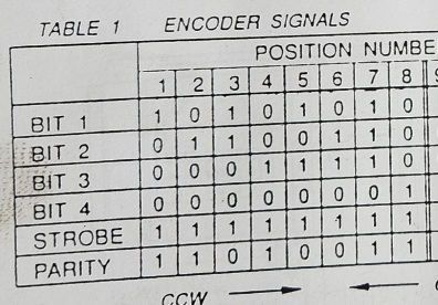

My encoder table is attached , it does use 0,0,0 for 8
I'm on linuxcnc 2.9 , installed about 1.5 months ago, I will update the carousel.comp this evening when I go back out to the garage , and I will do up a table of the sense inputs.
If I do retain the encoder I will have to add something to verify the turret clamping prox input , i noticed when using the encoder sometimes it would see the encoder position when it was not close to clamping position.

Some more headway with the encoder , I replaced the strobe I put with the Input from my clamp prox , this seems to work.
I did the fix you sent me to but that was for the gray code section and the binary section has some different code.
So when it looks for tool 8 all it sees is 0-7 , and just spins until you close linuxcnc

I'm taking a little break form the encoder and just attached my index switch for now , i do want to have the encoder working but its kicking my butt. I can switch between encoder and index setups in about 10 minutes.
Another thing I noticed is it seems to count backwards , if your at t2 and call t3 you wind up at t1 but the bits say t3 , maybe the old controller flipped it in software.

Seems like miss wiring, be it physical wires or in hal.Another thing I noticed is it seems to count backwards , if your at t2 and call t3 you wind up at t1 but the bits say t3 , maybe the old controller flipped it in software.
Do some tests and write down what pin state denotes what tool, then change in hal accordingly. Much easier that dealing with wires.
