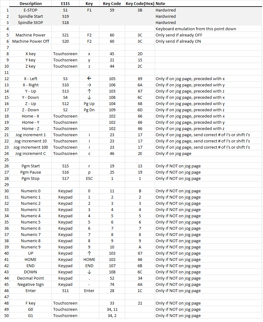

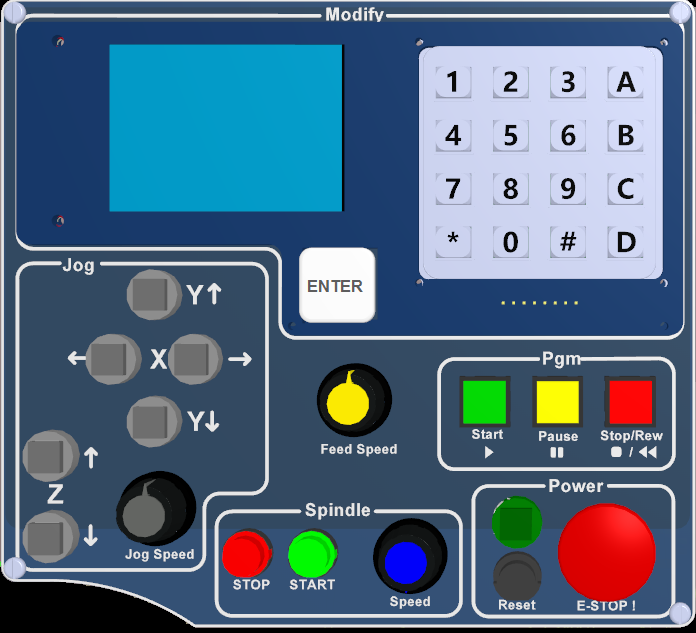

Thanks to a lot of help from members here I now have my knee mill fully operational. Next task is to make some sort of mostly push-button user interface that I will mount to the belt cover. I prefer pushing buttons than mouse clicking for repetitive tasks. Conceptual sketch is below.
I will use an ARM uC that has a USB support and I could configure it as a HMI device (basically emulate keyboard presses), for example pressing the Green Power button will send a "F2" to LinuxCNC via a USB port. I think there are keystrokes for most if not all of the buttons shown below?

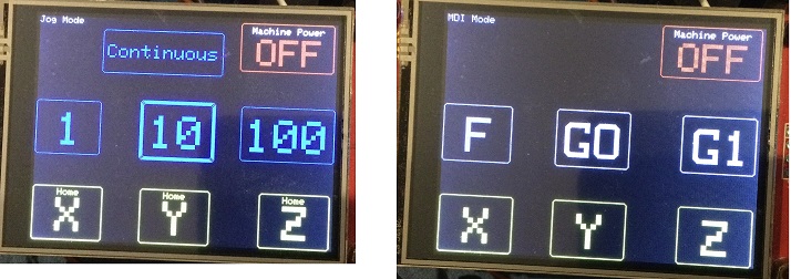

The display is also a touchscreen and I'm hoping to leverage that to emulate additional buttons/keystrokes based on how the machine is being used for example having buttons for common commands like G0, G1 etc.
It would also be good if I could display things like alarms on this display for example if a limit switch gets activated it could pop up an error on this display.  I imagine there is likely more than one way to accomplish that.  What would be the best way to get say a limit switch error message from LinuxCNC back to this board?

Replied by andypugh on topic Data transfer LinuxCNC to / from custom board
Keystrokes are a pretty bad way to interface to LinuxCNC.
Can I suggest that you consider a Mesa 7i73 ? That can interface the control panel directly into the realtime layer of LinuxCNC.
store.mesanet.com/index.php?route=produc...oduct&product_id=116
It's probably not as much fun as your custom board, but it will work out of the box.
There is a strange HAL component that I wrote that might help if you choose to go your own way. It's strange because it does two completely different things in one component.
linuxcnc.org/docs/stable/html/man/man9/matrix_kb.9.html
The side that might help you is converting scancodes into HAL pins.

I'm exploring the various ways to get data to and from Linux to my board. I already have hard wires connections for EStop, and machine power.
Focusing for the moment on data from my board to Linux I made a table of the 50 or so button presses that I would need to send, and from playing with a Axis and a regular keyboard using showkey it seems there is a hot key or key sequence that covers all 50 buttons that I anticipate using. There are a few anomalies that requires sending two key strokes or in the case of the jog increment keeping track of how many I's or shift- I's were sent so that has the potential to get out of sync, but other than that it seems really straightforward to just have my little on board uC scan my buttons and send the key or key sequences based on the keycode in the table below.
I found the table "most Common Keyboard Shortcuts" in the Axis documentation.
Do you know if there are additional commands documented elsewhere?
When you say it's a pretty bad idea to do this perhaps there is something I have overlooked?.
The Mesa 7i73 is interesting, but probably not a good fit for this project for a couple of reasons:
1) Physically if mounted as a daughter board would make the overall board depth thicker than I want.
2) I want to use the little touchscreen as I have used it before and it allows easy GUI enhancement in the future for things I can't anticipate now.
Assuming this will work for data to Linux, I now need to put my thinking cap on to figure out how to best get the Linux status data I would like to use back to my board so I can optimize the GUI. Jog Increment value would be a good start, I need to make a list.
