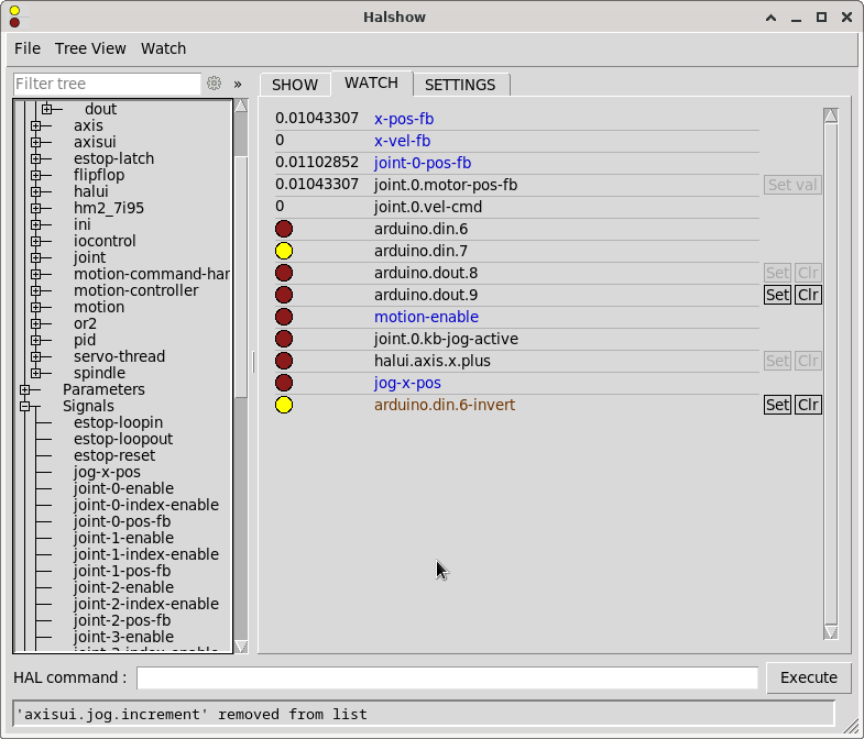

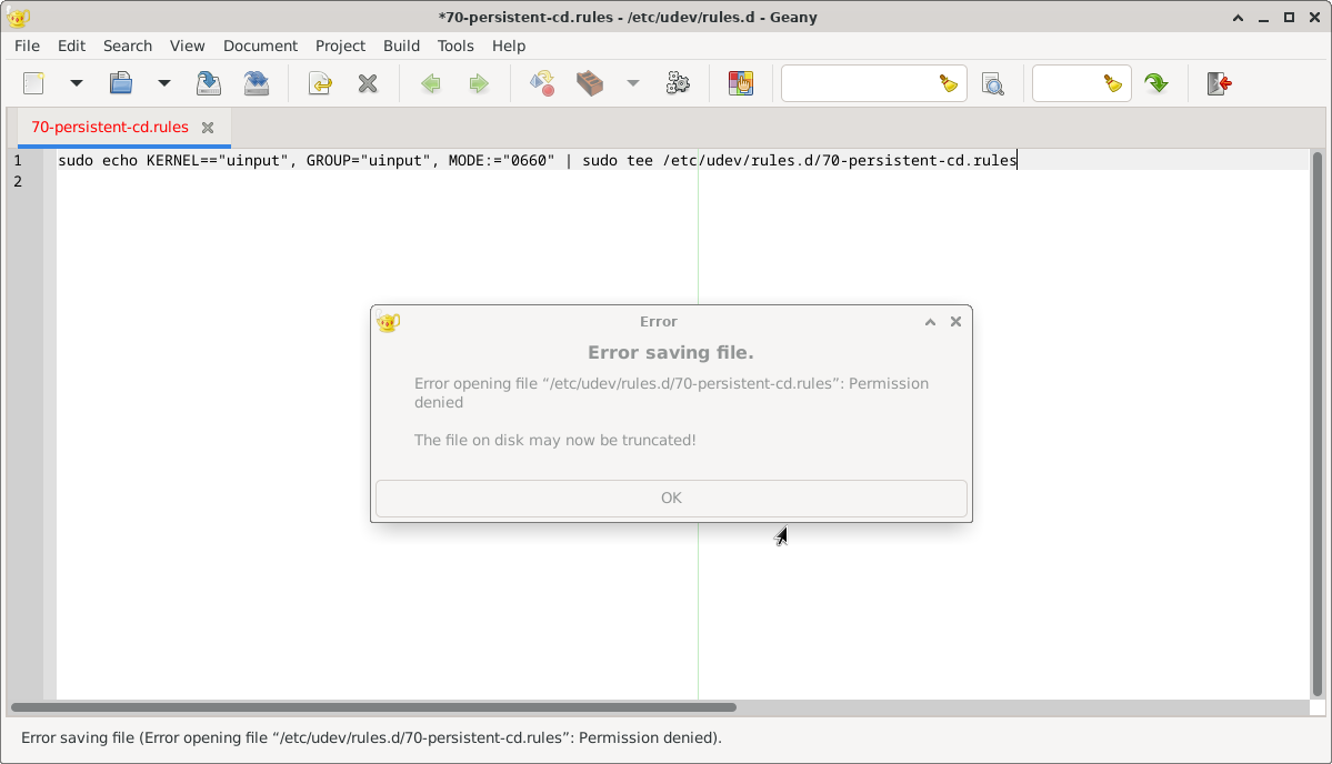

I need some clarity on a few points for sendkeys.
At this point I have an Arduino board that can trigger events in halshow, So when I activate an Arduino connected push button, the jog-x-pos and the halui.axis.x.plus changes from yellow to red. I expect the actual X-axis to jog when I press that button, however other than the yellow to red indication nothing happens. (the system is NOT in Estop, and the machine is enabled on the manual control tab. If I mouse click on the "+" button, the x axis does jog.
Do I need to enable/invoke SENDKEYS, to actually get the yellow to red indication of jog-x-pos to do something?
Assuming that I do need to enable SENDKEYS, I need a little help with a few points in the SENDKEYS documentation.
Instructions say "Create a new entry in .B/etc/udev/rules.d/99-input.rules"
I'm not sure where ".B" is?
I did find /etc/udev/rules.d/70-persistent-cd.rules
So neglecting the missing ".B" I assumed this is the file I'm supposed to update?
However when I add "sudo echo KERNEL=="uinput", GROUP="uinput", MODE:="0660" | sudo tee /etc/udev/rules.d/70-persistent-cd.rules" to that file I get the attached error message. So lots of possible mistakes here: wrong location, wrong file, adding the uinput group did not work even though it seemed to (see last attachment) the discrepancy between 99-input.rules ,77-persistant-cd.rules , 88-input.rules?
Please advise.

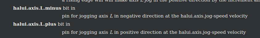

01 Aug 2024 18:55 #306653
Replied by Aciera on topic Data transfer LinuxCNC to / from custom board
- slowpoke
- Posts: 224
- Thank you received: 28

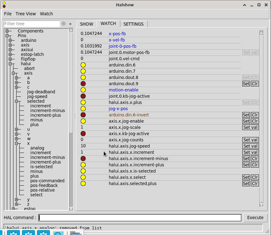

01 Aug 2024 22:18 #306679
by slowpoke
When I press the Arduino button, the jog-x-pos and the halui.axis.x.plus indicators both change from yellow to red. For some reason they don't trigger an actual jog.
Replied by slowpoke on topic Data transfer LinuxCNC to / from custom board
Thanks for that, however setting halui.axis.x.plus did not help.Note that 'halui.axis.jog-speed' needs to be set for plus minus jogging: linuxcnc.org/docs/html/man/man1/halui.1.html
