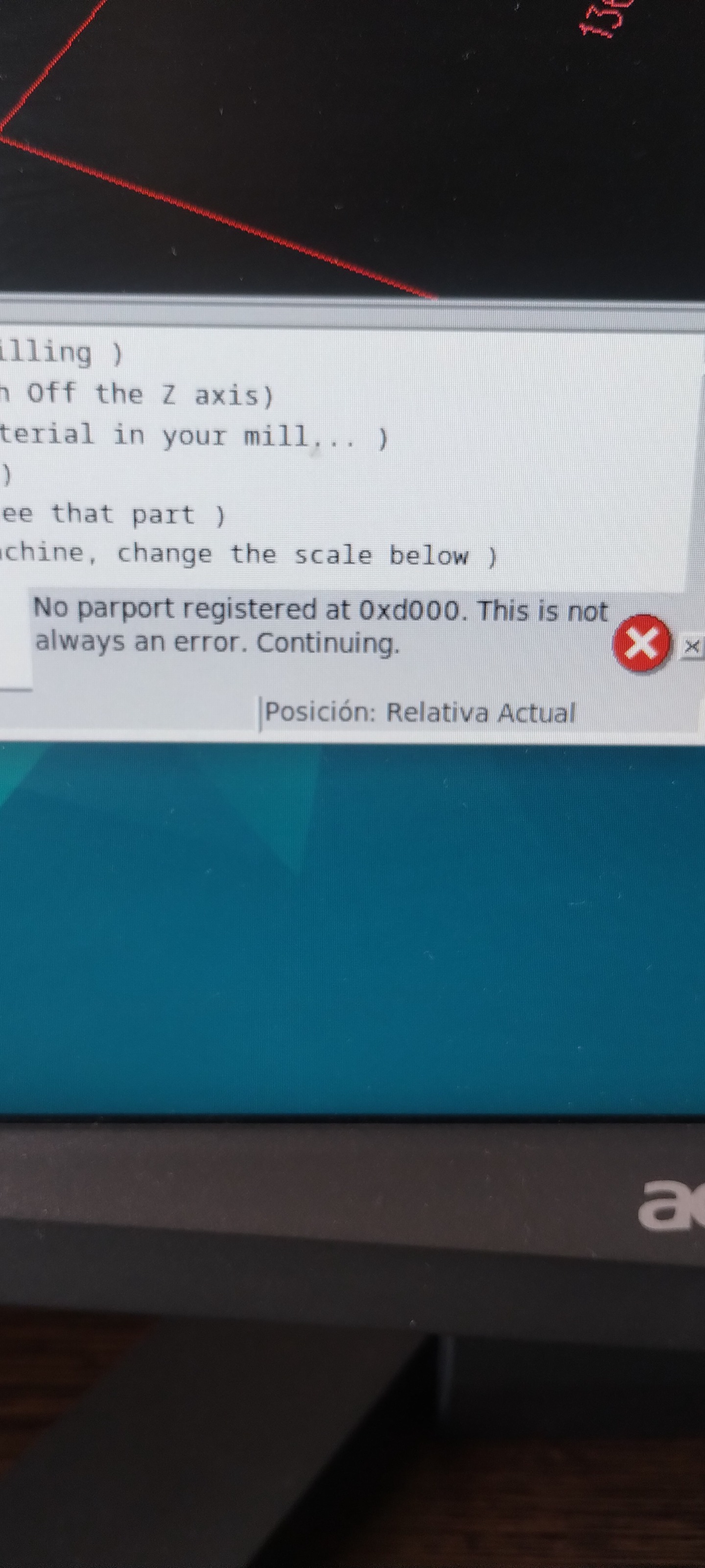

14 Mar 2025 15:04 #323931
by RobotMatic
PCIe - No parport registered at "0x " . This is not Always an error.Continuing. was created by RobotMatic

17 Mar 2025 16:22 #324127
Replied by tommylight on topic PCIe - No parport registered at "0x " . This is not Always an error.Continuing.
Had the same issue yesterday, PCI-E Sunix card, works perfectly but the error shows up whenever LinuxCNC is started.
Did not bother with it, but i did notice LSPCI does not show loaded module for it at all, but it does show all the other info with addresses and stuff.

17 Mar 2025 20:15 - 17 Mar 2025 20:22 #324148
by unknown
Replied by unknown on topic PCIe - No parport registered at "0x " . This is not Always an error.Continuing.
As the message says it's not really an error, I think the only way to stop the message would be to modify the hal_parport code, or I not sure if this would work but add a debug level when loading the driver. First would work but means compiling Linuxcnc one's self the second option is just a guess.
If the machine works I wouldn't bother too much about it. Yeah it is a little annoying. But then again you have the convenience of CNC

17 Mar 2025 23:59 #324159
Replied by PCW on topic PCIe - No parport registered at "0x " . This is not Always an error.Continuing.
Yeah, this deserves a log file entry for debugging, but not an error pop-up...

18 Mar 2025 01:29 - 18 Mar 2025 01:43 #324162
by unknown
The chips used in these cards are multi function,some of them can be strapped to work as SPI ports. Or they can be configured for a combination of serial only or serial & parallel ports. The kernel does not take the board as a serial PCIE port. Whilst some do load the parport_serial driver that does not mean it is seen a just a serial PCIE port.
I have a multifunction card installed that uses the parport_serial drive
As you can see it is recogonised as a parallel port at 0x3000.
Now for the serial part of the card, there is also an on board serial port at the "regular address"
As you can see it is recogonised as a serail port at 0x3008.
The device doesn't say "I'm a parallel port" the kernel loads the driver depending on the devices PCIID
As you can see the this is the list of ID it is loaded for.
The message comes from /src/rtapi/uspace_rtapi_parport.cc
I'm not at all sure what you mean by a "parallelized serial port".The non-native parallel port is a parallelized serial port. The Linux kernel takes it as a serial PCIE port. That's where linuxcnc comes into conflict and raises the alarm. The older parallel port PCI expansion boards were neater and sent the OS the message (I'm a parallel port). This Generation does not, that is why this alarm appears that tells us (continue, it may not be a mistake). The issue is that linuxcnc starts in a messy way and I would like to solve it.

18 Mar 2025 02:29 #324165
I'd probably just change:
rtapi_print_msg(RTAPI_MSG_ERR, "No parport registered at 0x%x. "
"This is not always an error. Continuing.\n", base);
to
rtapi_print_msg(RTAPI_MSG_WARN, "No parport registered at 0x%x. "
to
