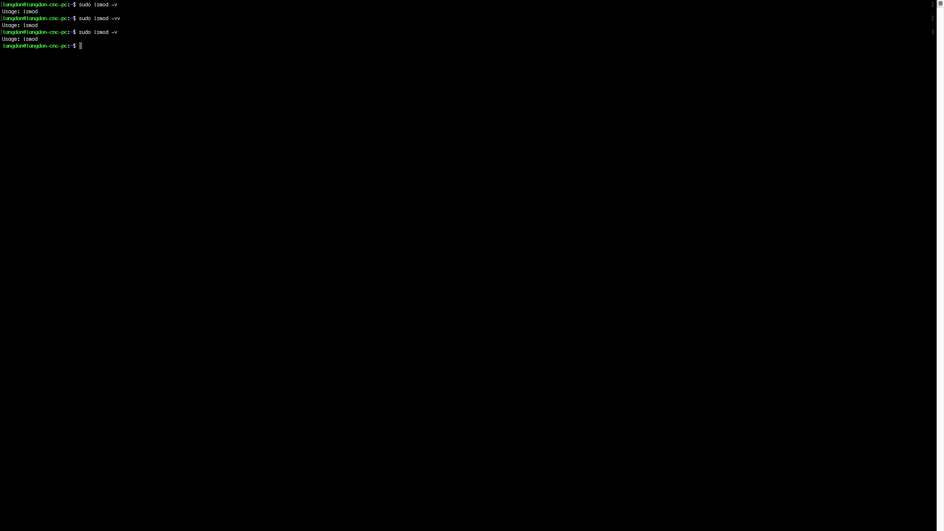

02 Apr 2025 20:23 #325539
by ContinenteCNC
Replied by ContinenteCNC on topic PCIe - No parport registered at "0x " . This is not Always an error.Continuing.
I wonder if there is a way to force these Sunix cards to load parport_pc driver and module from the I/O ports address?
So it will showup in dmesg as a proper enumerated parallel port.
It would make my life easier. I wrote a bash script to automate PCI card report creation ( forum.linuxcnc.org/18-computer/54368-pci...-box?start=30#325532 ) and I have a bunch of PCI cards to test and report, and some of them are Sunix.
Do any of you guys know a way?

02 Apr 2025 23:59 #325562
by unknown
Replied by unknown on topic PCIe - No parport registered at "0x " . This is not Always an error.Continuing.
First thing you need to do is get the pci_id.
That will show you a list of PCI IDs and module parameters.
Then you can use modprobe to load partport_pc using the parameter that's required to set the address of the card.
Now whether the kernel module loads automatically for that card will depend on whether the PCI ID is a match with the driver.
If you can give me your kernel version and PCI ID of the card I can check the kernel sources and see if I can find a match. If not for the kernel you're running but one that might.
In all honesty for the headaches that a parallel port can cause a mesa 7i92 plugged into your existing breakout boards is a better solution. Latency isn't a problem, migration to a another PC is easier.
But I get that parallel port cards can be cheaper.
modinfo parport_pcThat will show you a list of PCI IDs and module parameters.

03 Apr 2025 01:29 #325565
by ContinenteCNC
And the bash script I wrote to automate reports assumes it is an enumerated port. If its not, it won't work.
I tried using modprobe, setpci and some others, but linux is high in my list of "things I like doing, but I'm also bad at doing".
I thought it might be something trivial to do, but if it is not, nevermind. It is marginally more convenient to find base, extended addresses and available modes (they showup in dmesg and /proc/sys/dev/parport/parport*)
Why?
I had two of those, both showed everything on 2 different PC's, but 1 did not show driver and kernel module on a 3'rd PC. Same card did show on 1 PC and did not show on another PC.
On the PC that did not show modules another PCI card did not show modules loaded, after showing them and working for years.
All this points to something in BIOS causing that, but i am out of luck as i can not find any more of those Sunix cards.
Here is one example of it showing modules loaded
forum.linuxcnc.org/10-advanced-configura...uing?start=20#324494

03 Apr 2025 01:44 #325566
by ContinenteCNC
I love mesa cards, but unfortunately I can only use them in high end projects. Things get expensive really fast bellow equator line.
I believe I have attached everthing you've asked. Let me know if you need some more info. Thanks!
modinfo parport_pc That will show you a list of PCI IDs and module parameters. Then you can use modprobe to load partport_pc using the parameter that's required to set the address of the card. Now whether the kernel module loads automatically for that card will depend on whether the PCI ID is a match with the driver. If you can give me your kernel version and PCI ID of the card I can check the kernel sources and see if I can find a match. If not for the kernel you're running but one that might. In all honesty for the headaches that a parallel port can cause a mesa 7i92 plugged into your existing breakout boards is a better solution. Latency isn't a problem, migration to a another PC is easier. But I get that parallel port cards can be cheaper.
