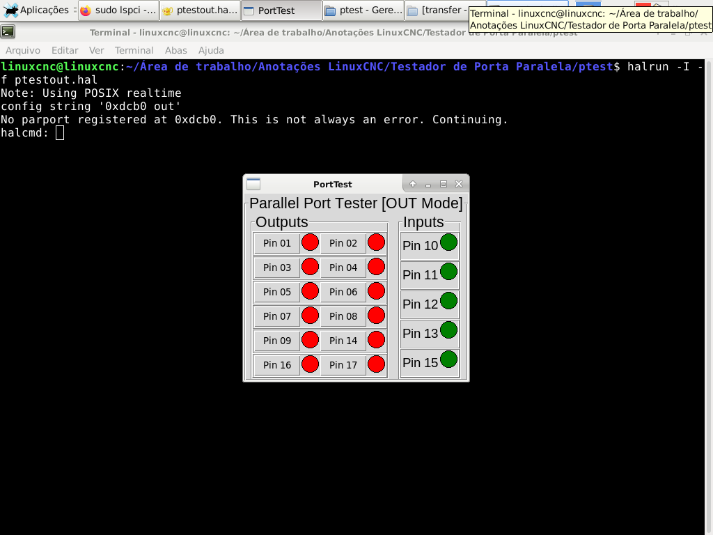

24 Mar 2025 01:37 #324712
by ContinenteCNC
Thank you for the tip!
This is the message showing up:
I have two cards, the top one it the PCIe Sunix 2212, the botton one is the PCI Moschip MCS9805CV (sudo lspci -v)

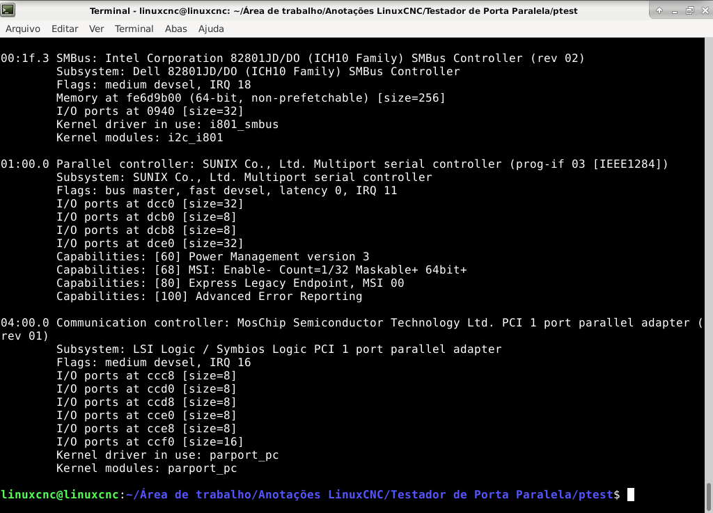

This is the output from sudo lspci -vv for both cards as well (maybe it helps)

Replied by ContinenteCNC on topic PCIe - No parport registered at "0x " . This is not Always an error.Continuing.
Picture, capabilities access denied, that is usually due to not using sudo, so
sudo lspci -v
see if it shows the driver and kernel module.
Always use sudo when dealing with kernel level stuff, for reading only.
As you can see, no driver and no module.

24 Mar 2025 01:54 #324716
Replied by tommylight on topic PCIe - No parport registered at "0x " . This is not Always an error.Continuing.
Yup, missing module and driver AND using IRQ11 in your case, so there goes my "above 15 IRQ issue" out the window!
FLAGS!!! they are not the same (everything else is), yours has Bus Master and Latency shown, my friends PC is missing those.
Now that is something to chase...
