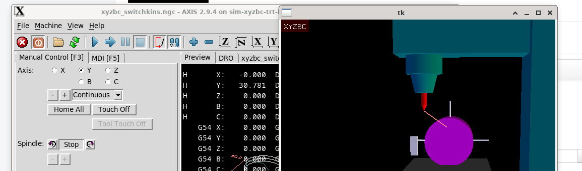

17 Apr 2025 17:44 #326531 by jochen91
Hi Aciera,
thank for the input. Today I started to configure vismach, when i realized that my TCP moves seem off by quite a bit. Which leads me to the following questions:
With the Mazak Z axis is lying horizontal and X standing vertically. -> So i switched X and Z in my vismach model and everything's fine. But in TCP i realized that if i switch between normal and TCP my Z axis was moving left and right. Which had to do with the X/Y offsets for TCP. Witch made me lead to the conclusion, that in the TCP calculation the tool-offset need to be applied to X and not Z. Which than begs the question if the formulas for X and Z need to be switched completely.
So i started doubting everything and searched the forum. I found your XYZBC-TNR example which sadly i can't run right now because of some permission problems:
:0: execv(./vismach/xyzbc-tnr-gui.py): Permission denied
But I'm still not quite sold if i can copy the the TCP math from this example. With the Mazak the head is swiveling around Y (B-axis) in your example it's a dual table config.
I would be real glad if you could give me some input on:
- 5 - axis Kinematic with swiveling B axis head
- The X and Z axis switch debacle
17 Apr 2025 18:26 #326535 by Aciera
I have a sim config for a b-axis head / c axis table in my suite of twp-configs on my github site:
github.com/Sigma1912/LinuxCNC_Demo_Configs/tree/main
to test this you need to:
1. download and unpack the folder 'LinuxCNC_Demo_Configs-main'
2. from the unpacked folder copy the folder '5axis-twp' and paste it into your 'configs/sim' folder
3. right click->Properties->mark as executable the following files (otherwise you get the permission error you got):
- '5axis-twp/twp-helper-comp.py'
- '5axis-twp/vismach/xyzbc-trsr-gui.py'
