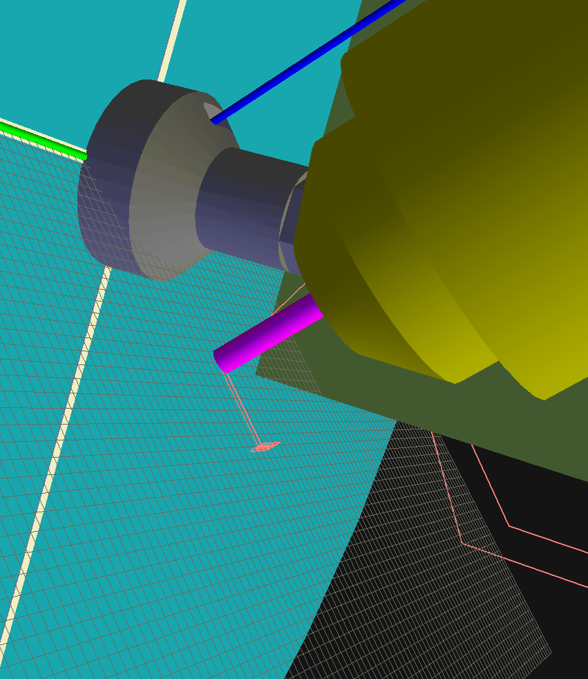

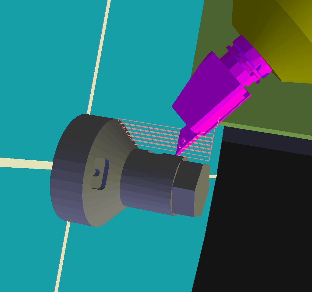

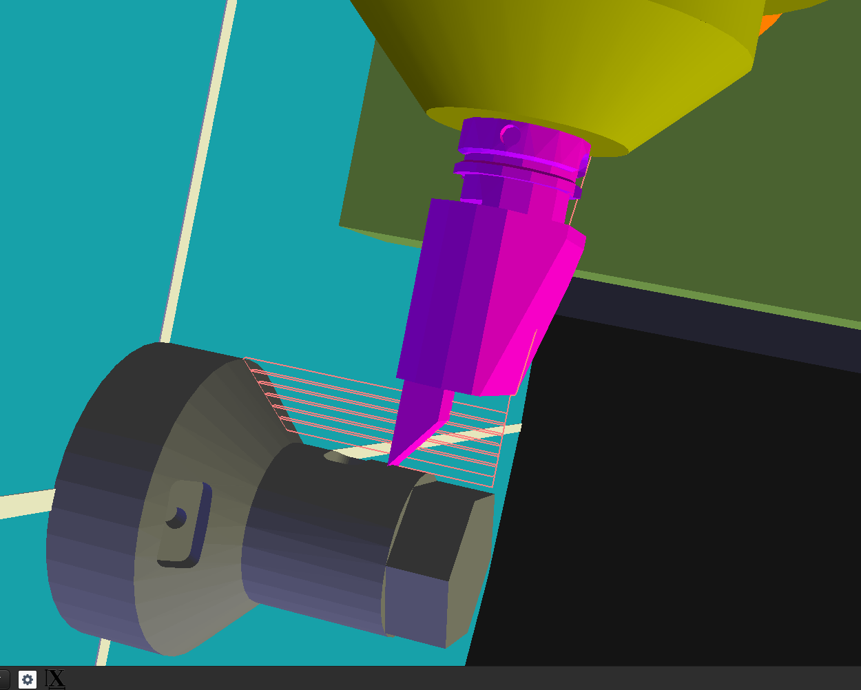

Note the tilted b-axis to compensate for the chosen tool:
Alternatively the operator could also orient to tool spindle 180° (m19 r180) and run it with b0 and the work spindle turning in the opposite direction:
As already pointed out, the milling operation using 'G19' does not work:
Is there a way to change this to 'regular' G17 in the PP?

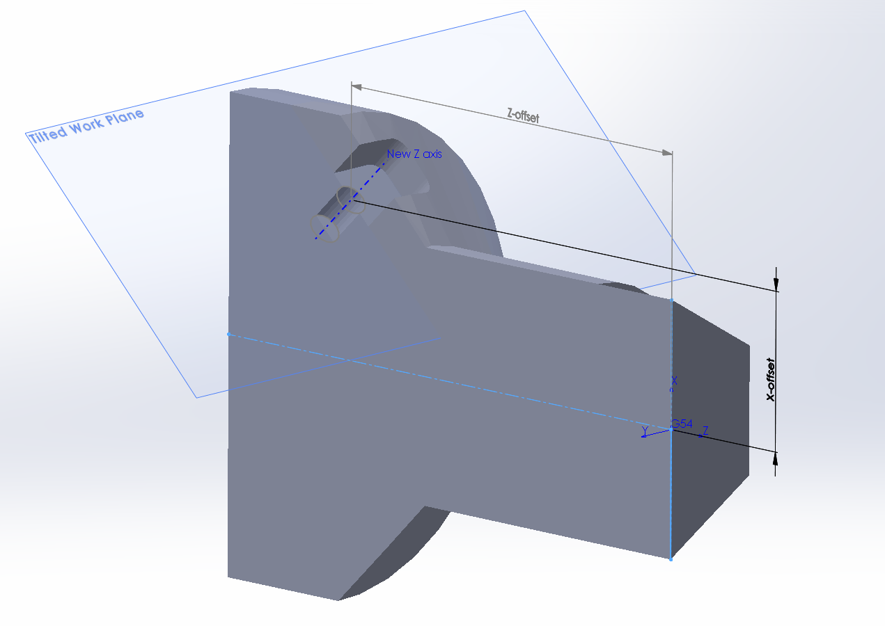

I see. I'm not very familiar with editing post processors so I have no idea what's possible. I've made a sketch to give you an idea of how Tilted Work Plane (TWP) would work in the example part.
What we need is the offset from the current WCS (G54) to the new origin of the TWP. After that we can use regular 3axis gcode to mill the feature on the inclined plane.
Note that the g68.3 command accepts an optional 'R' word to change the direction of the new X axis.
